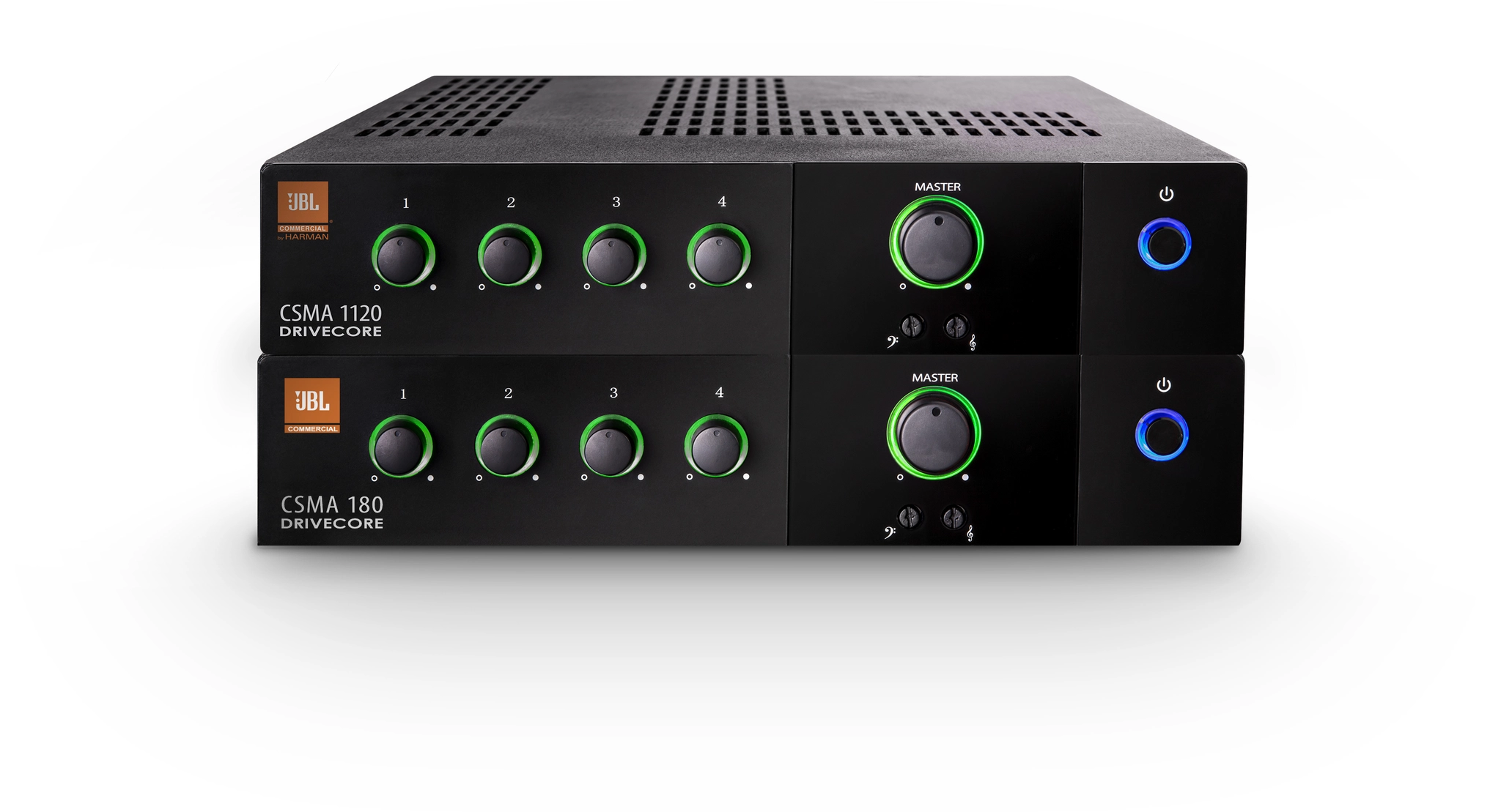

JBL Commercial has a number of small, flexible amplifiers designed for Cafe and similar small retail use:
I use the CSA-2120 in my home system. Lab.Gruppen have a similar product line in the LUCIA products. You probably want mono; there's no point in stereo for a widely-dispersed system. Depending on how many speakers are needed to fill the space, a 70V system may be best, although that is beyond my expertise.
I don't know about the 60dB limiter in Croatia - that seems very quiet. I have fond memories of visiting Croatia on my honeymoon years ago, and I recall the soft shuffling sound of thousands of people's feet on the cobbles of old town Dubrovnik, which struck me as a very ancient human sound. It would be a shame to drown that out, so I see the value of such a limit.
edit: corrected link to 'mixer' amps, with multiple inputs.
