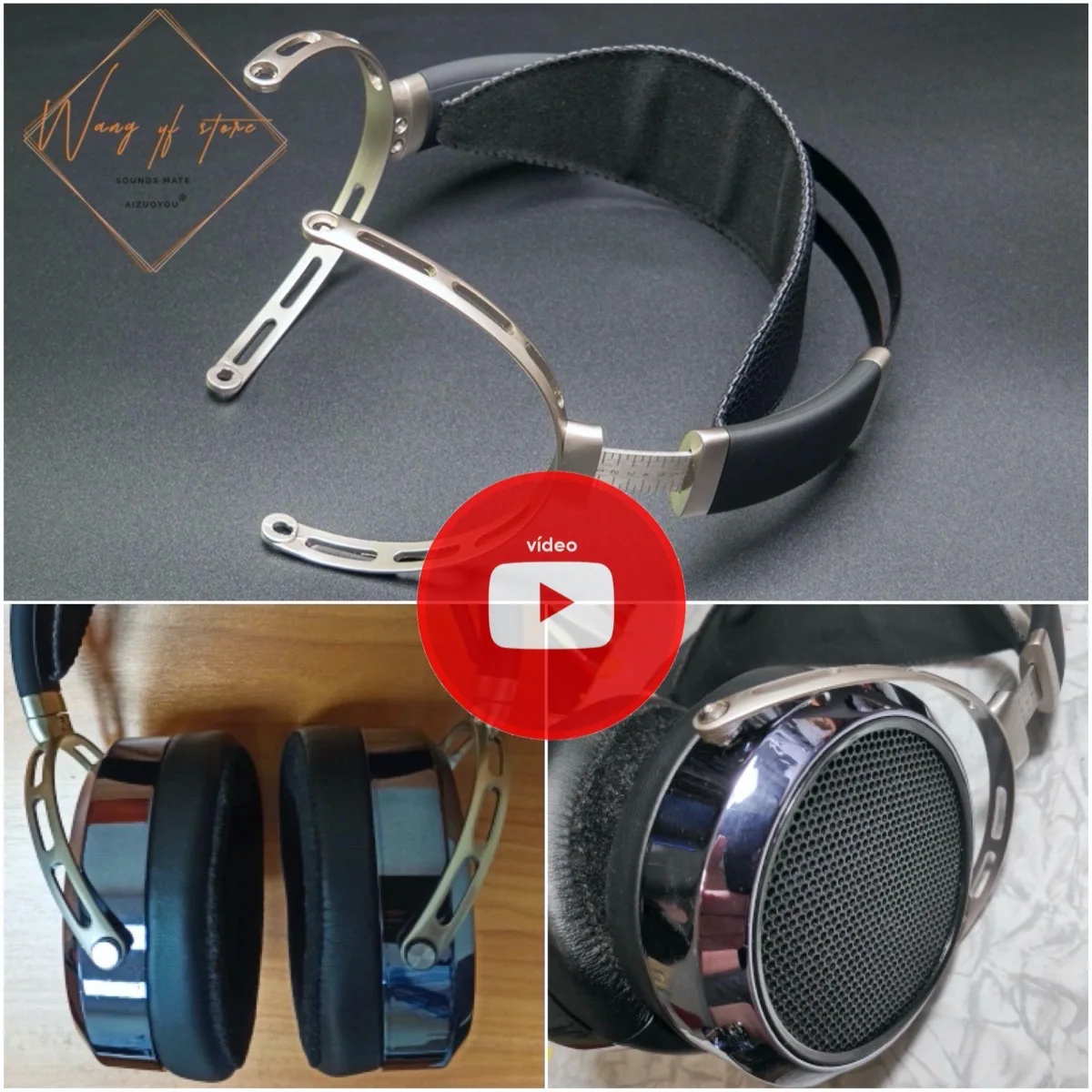

  • The "new" head band is not comfortable at all (the HE560 are way more comfy) and, after a careful kneading of the "leather" band, I am still contemplating to change it for this one:

  • The ear-pads are scratchy, actually they play in the same league as Grado ear-pads ! I immediately spent 40 EUR to replace them : on Hifiman headphones, replacing the pad is not so easy because of those crappy plastic rings (a nice and simple improvement would be to ease the ear-pad replacement...)

What did you switch the pads with? Is the plastic ring reusable or was it glued to the pad? Im still too afraid to tinker with it, though i have no problem with the stock pads other than it's a lint/hair magnet.
The plastic rings are glued to the pad, but you can buy them separately on the hifman store or on alibaba. You can buy spare earpads from dekoni (not cheap), brainwaz, etc. Then, for the next DIY step, I strongly advice watching a tutorial...
