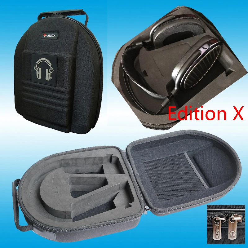

Does anyone have a hard case for their XS? If so, could you provide a link?

A case I already have. I expect it to fit well. If not the foam is quite flexible and easy to modify/cut:
Thanks for the option! I was hoping to use the case I have on my 4XX or 6XX but I don’t think they will be large enough.
de.aliexpress.com
39.69US $ |V MOTA TDC Headset Tragen Fall Boxs Für Audeze LCD 2 LCD4 LCD3 LCD X LCD XC HiFiMAN HE 400i HE560 I Felsen Edition X V2 (Koffer)|box for|box boxbox case
I got one.
The EDX cups only fit perfectly if the cups are together in the centre. The case has a raised centre section, otherwise the sides of the case are too shallow.

I got this for my Sundara (which I sold after getting the XS). Fits the XS just as well.
