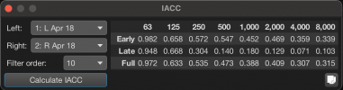

PS. I can't evaluate the IACC calculation... what do you think it is?

The IACC is a measure of how similar left and right speaker impulses are to each other. What you want is early IACC to be as high as possible (1 = exactly the same). Values above 0.85 are good, above 0.9 are very good. I don't know what values REW uses for "early" and "late" and I could not find it with a quick examination in REW's online manual.
Your early IACC is very poor. Everything from 125Hz up is less than 0.7 meaning that the sound from your left and right speakers are not identical. The obvious reason is how you have placed your speakers. DSP can help somewhat, but ultimately physical problems need physical solutions. If you are unable to find a way to place them better in your room, there is nothing DSP can do to help.
Disclaimer here: I am used to reading IACC in Acourate, which expresses it in % (i.e. > 90% is very good, etc). I am assuming that REW has normalized IACC to 1. If this assumption is wrong, throw everything I said above out the window.
There is an explanation here
The IACC (Inter-Aural Cross Correlation) panel is used to calculate the early, late and full IACC values for a pair of binaural measurements. The zero time for the measurements is taken as the earlier of the two measurement IR start times. The division between early and late is 80 ms later. The end of the "late" period is 500 ms or the end of the Schroeder integral (where the integral falls into the noise floor), whichever is later. REW does not change the alignment of the measurements, if they need to be aligned the Cross corr. align option may be suitable. The measurements are filtered with one octave, zero phase bandpass filters of the chosen order.
