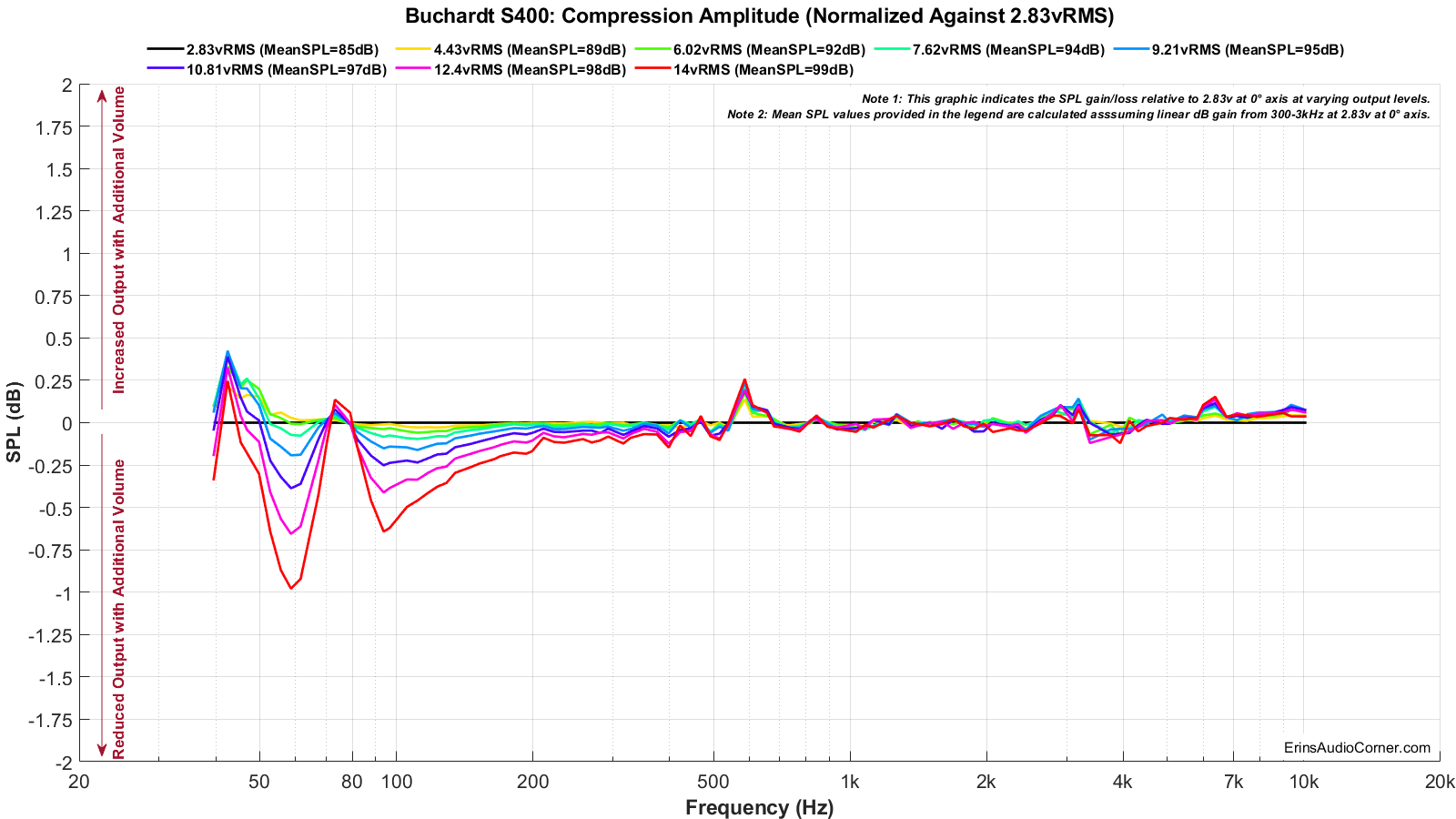

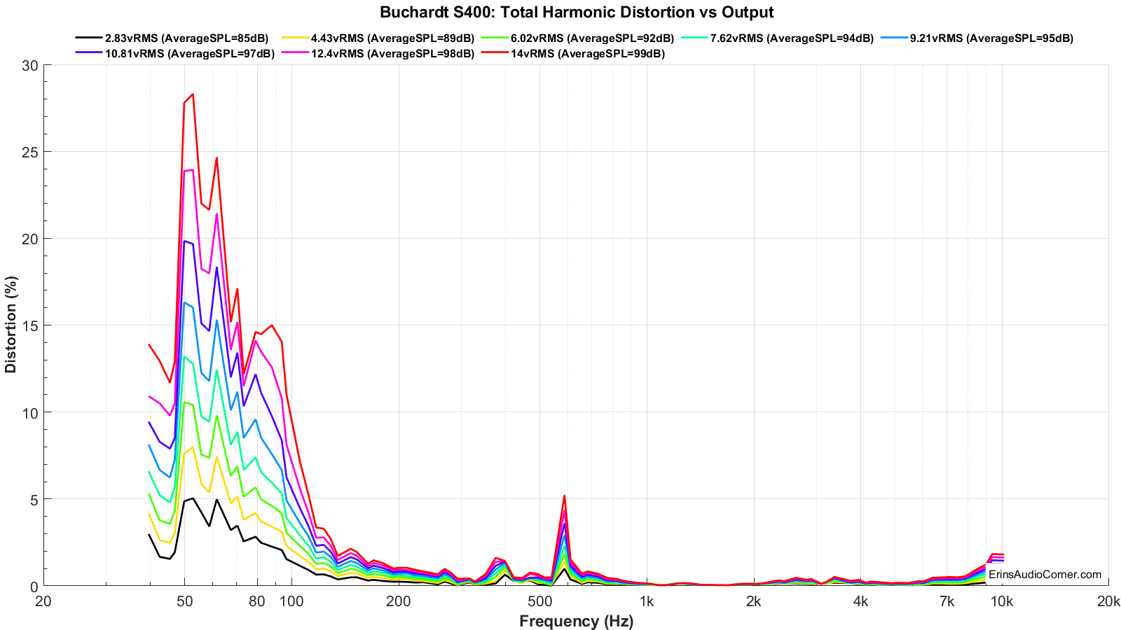

No wonder they released it with the Purifi driver. It should help out with the low end significantly, especially at higher volumes.
Note that was the original S400. The MKII uses a different woofer, the NRX2 which is paper. We haven't seen Klippel distortion measurements for that yet, but they could be different. I will say that they "sound" cleaner than the original, however I never felt that the original was lacking. I think cleaner just sounds like less bass in this case, which may or may not be preferred.
