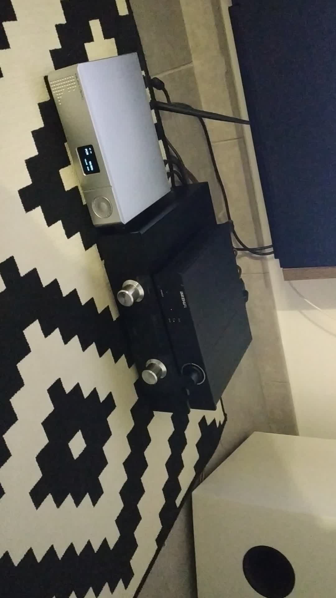

I am having a tough time locating that specific "BRZHiFi 3255XLR" (as the front face-plate in your photo shows).
I use the BRZHiFI #PA-10 as a desktop hardware (coupled to a SXM + PC (via WXC-50) and some Dante dongles.

Did you compare it VS any TPA325X amp ?
