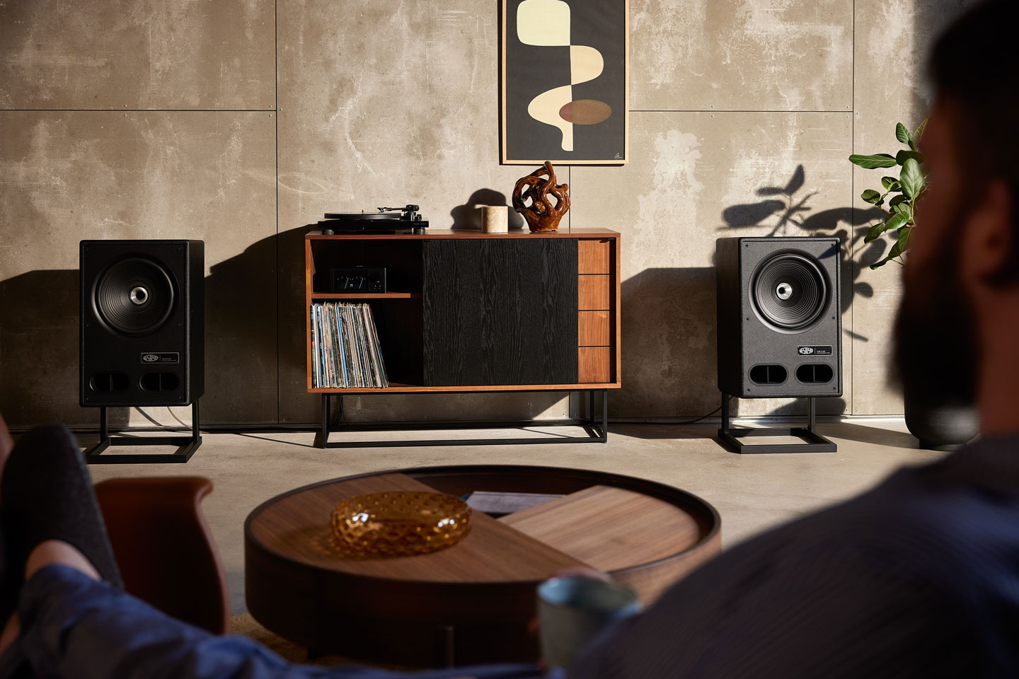

I would suggest to buy used. @CarlToft how much space do you have where the speakers would be placed?
If enough space I would think you would absolutely love this kit:
AMP:
Speakers:

Interesting option. This is the first I have heard of those speakers. Personally, I do like coaxial drivers. I did a brief Google search looking for objective test data on those speakers akin to what Erin and Amir produce, but did not find anything.
The Yamaha is $900 here in the U.S., so that would leave around $700 for the speakers given the OP's budget. What would be the price for the system in Denmark?
The total is a bit over budget. But as I also wrote I would buy used.
The 2nd link is to a German review site that has measurements.

The frequency response of the speaker looks a little rough, especially the dips around 160 Hz, 500 Hz, 1.1 kHz and 9 kHz. There is some roughness in the impedance graph around 160 Hz and 500 Hz, so there may be some sort of resonances happening at those frequencies. The impedance graph looks smooth at 1.1 kHz and 9 kHz. So those dips may not be due to resonances. Perhaps diffraction? Maybe the review explains this, but I am not fluent in German, so I don't know.

Notably, the V12C speaker is fairly efficient, 89 dB (I assume at 1W at 1m), and is rated at 109 dB maximum SPL, with short-term peaks of 121 dB. So, it will play loud. It will do well at filling a large room with music. With a 12" woofer, the V12C is moving an appreciable amount of air, and with a paper cone I suspect it will perform very well with regard to dynamics. The -3 dB point on the bass extends down into the 40s, which will be fine for most people.
The review indicates that 1.1 kHz is the crossover frequency. That explains why there is a frequency response dip there without a corresponding blip in the impedance curve. Looking at the phase curve, there is large phase swing just above the crossover frequency. I suspect there is some phase cancellation occurring between the woofer and tweeter causing the dip at 1.1 kHz. Although the crossover uses air core inductors, which I greatly prefer, it looks to me like the crossover would benefit from additional engineering effort to get the drivers in phase at the crossover frequency.
The 9 kHz dip probably is due to diffraction occurring at the transition from the tweeter's horn to the woofer cone. These types of things are not an uncommon issue with coaxial drivers. It is a tradeoff, but one I tend to think is worth making to get the tweeter and woofer spatially aligned.
Personally, the V12C is not my cup of tea (I prefer more neutral tonality), but I can see a lot of people really liking the speaker, especially at its very competitively price of 1,298 euros/pair. In this regard, the V12C fits within the OP's budget. He should listen to a pair, he might like them.
