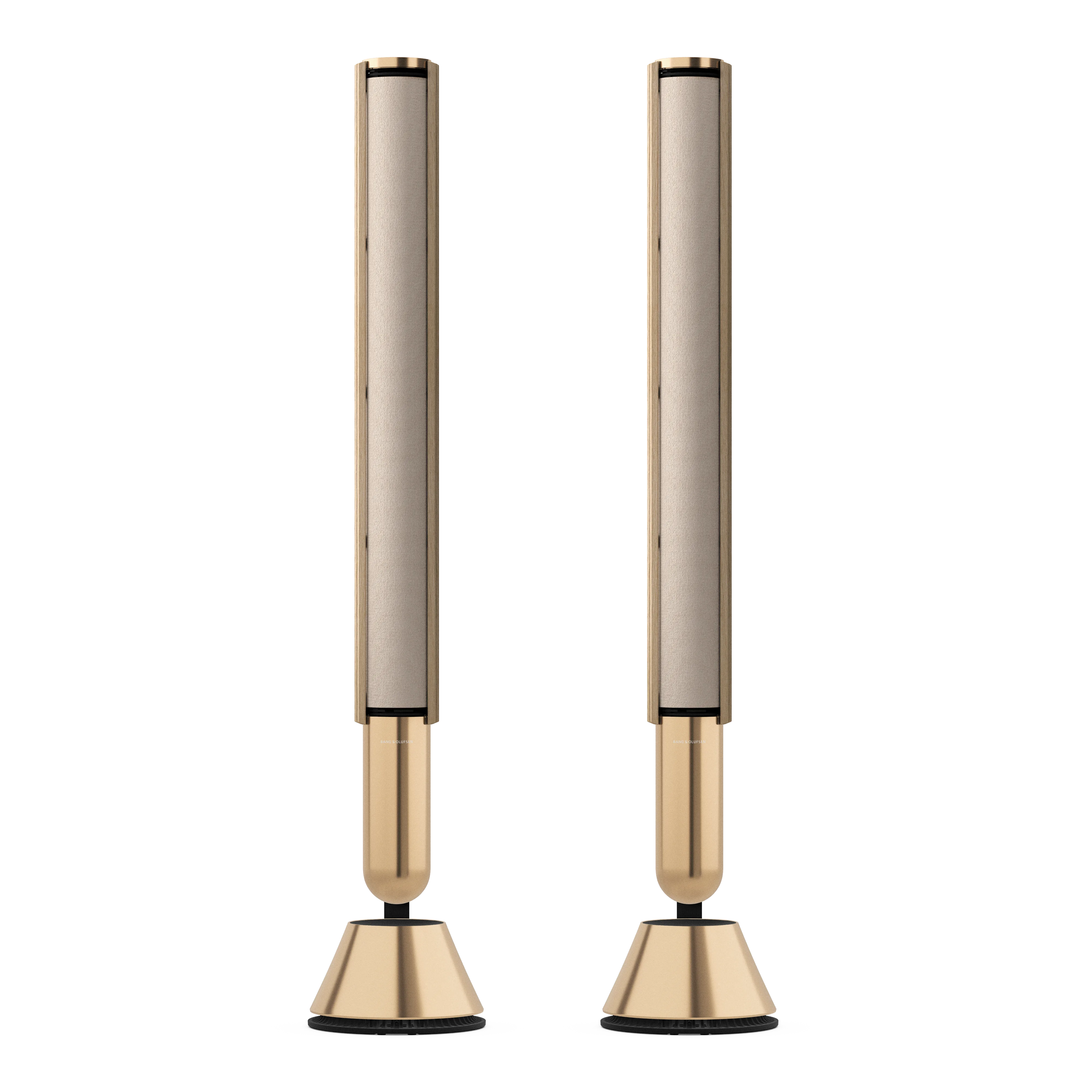

Here is what the SPeaker Looks like:
Photos:
Thanks to Lucksus sound for the images. And Banging Olsen.
I know they cost a good amount of money. This is art. And it's Art that you can use.
Its more like buying a sculpture in my opinion. Almost everything that they make is something of a statement piece.
