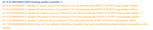

Just quickly tested with old rew measurements (only MLP) I had around from Nexus times, and two weird things are happening. First it detects all speakers (except for SW) are polarity inverted, and then it's setting front speakers to full range, rather than setting it's calculated 40hz crossover, meaning sub isn't activated unless the crossover is manually set in the AVR. Tried forcing minimum crossovers to 60hz yet same happens.

When all speakers need inversion, it should warn that none are going to be inverted? Pls share your mdat and . avr and let me check
You're right it does mention "Nothing wrong with your speaker polarities, all speakers may seem inverted when phase inversion is elsewhere in the system!", missed it.
