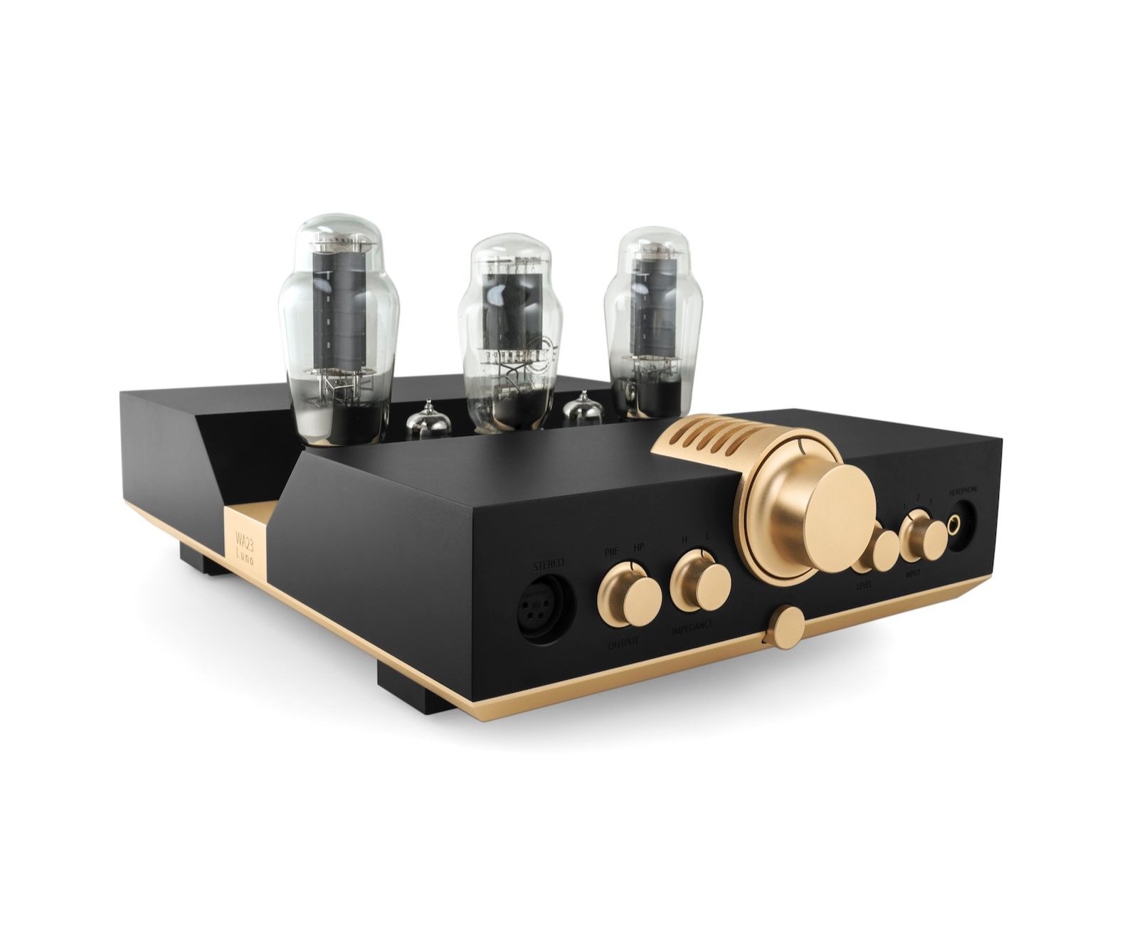

I saw a very expensive headphone amp looks like this recently and I don't get why people love tube amps so much.
Well, first of all, look at that amp. C'mon. It's really cool! Tube amps come in all sorts of designs, far more varied and IMO interesting than yet another boring, square-boxy solid state amp.
And the tubes glow! That's an aesthetic plus! :)
