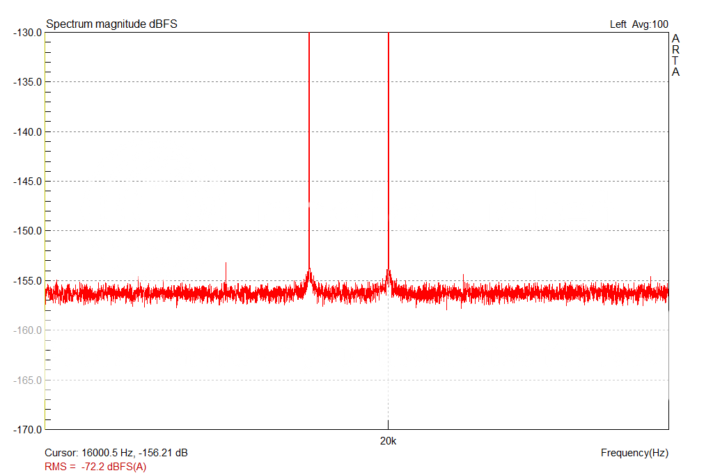

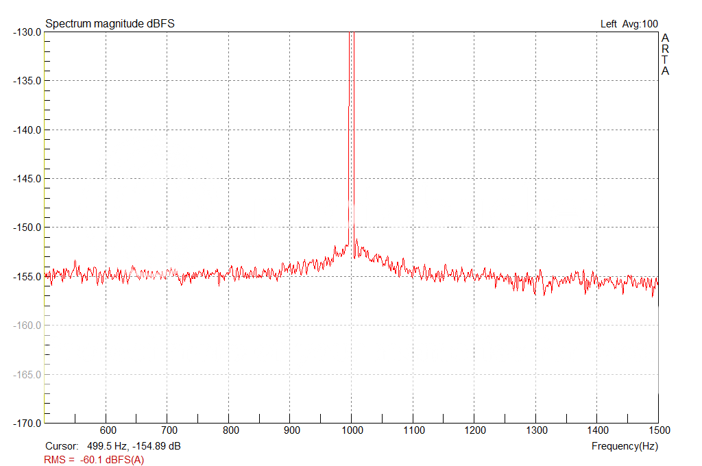

I dont have an Audio Precision. However what I use is very low noise and distortion, better than most DACS. :)
Here are some measurements of the MDAC you have been listening to.

Looks to be with a very low level stimulus signal, say -60 to -70dB. Now repeat at 0dB stimulus and re-post. Incidentally to be able to see noise floor modulation by comparing plots means knowing the effective bandwidth of each FFT bin for each plot. Care to post that up too?
Of course it will be higher - please refer to my initial post on this.
If you want to limit this to high level signals instead of the far more generalised statement OK, but it wont change the fact that the ADC is lower noise and distortion than the DAC.
It would have been a 131072 point FFT, but I cant remember if those particular plots were 48 or 96kHz

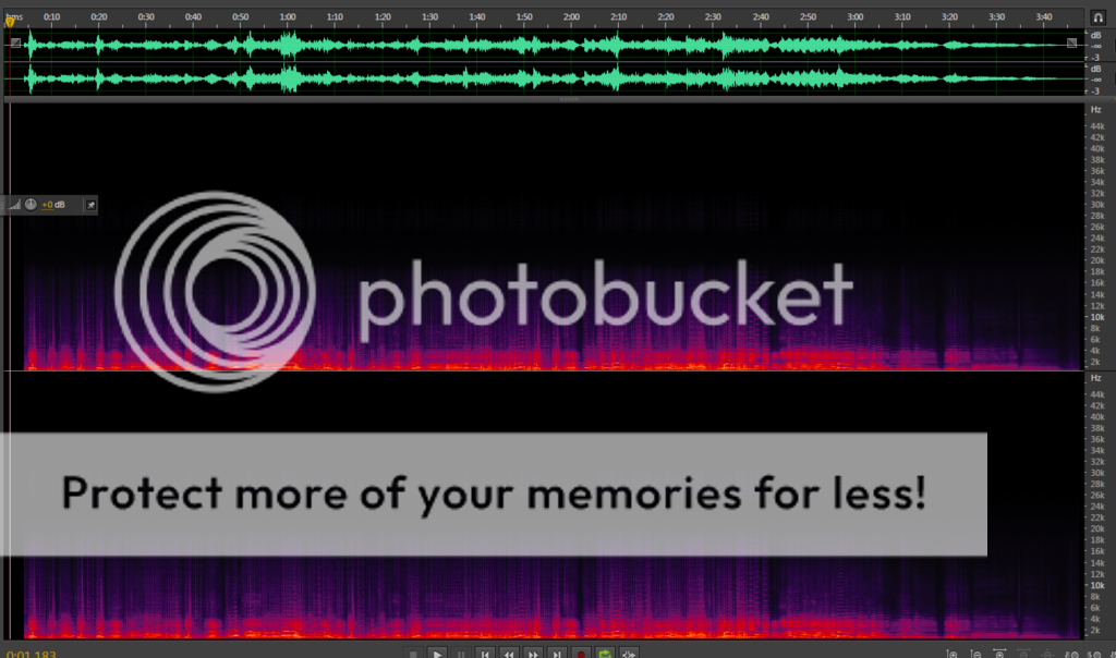

Just for info here is the track you sent me looking up to 48kHz with two different MDAC filters
