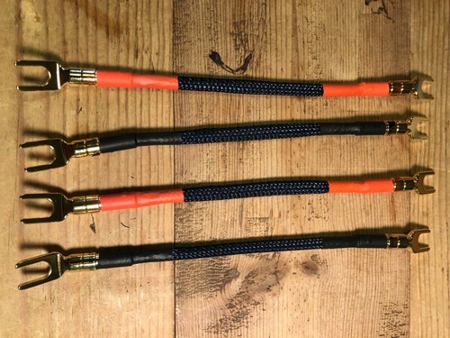

Well, not exactly cables, but what about those terminal jumpers which many manufacturers use? The jumpers that came on my Sonus Faber Lumina V towers are a joke. I can't believe how thin and chintzy these terminal jumpers are. All four jumpers together weigh only 7 grams. Two of them seem to weigh 3 grams. This puts them at around 1.5 grams, each. No wonder my bass had so little impact(I connect my speaker cables to the top terminals in an attempt to get the best high frequency sound).
20230429_135359-jpg.3441776
20230429_135654-jpg.3441775
20230429_140011-jpg.3441774
I've been rather underwhelmed by my Lumina V's from the start. Not that they sound terrible, but I was just getting very little mid-range and bass impact from them. They just sounded rather "blah" and uninvolving, to the point that I was thinking about selling them and getting different speakers. After stumbling across a YT video of a guy who purported that replacing the stock terminal jumpers with quality copper wire terminal jumpers improved the sound quality, I thought, okay, I have some good terminal jumpers on my old Legacy Audio speakers in the other room.
So, I removed the seemingly weightless jumpers from the Lumina's and installed the wire jumpers. Holy impact, Batman, my Lumina's roared to life. No way this much difference is expectation or confirmation bias, as the difference is not subtle. It's obvious that my power amp now has much greater and tighter control over the woofers. Man, the bass lines are so much more enjoyable to listen to.
Thoughts? I know this may run against the gestalt here, but if you have speakers with thin, chintzy jumpers, you might give it a try. I think these are the ones I have, which I got off of Ebay. They're not that expensive. I have no connection to the seller, in case you're wondering.

That could very well be. But having dealt with jumpers like that, they sometimes don't make good contact.

That may not be the big issue, even though it's annoying. Ones I've had developed an oxide layer, and unless you can wrench the speaker terminals and use a copper crush washer and dielectric grease, they'll probably just get flaky again. Most likely they were an afterthought when some marketing guy said they just had to support bi-wiring.

The resistance of these tiny jumpers pales in comparison to the resistance of the contacts (amp and speakers externally and internally), the speaker wire, the internal speaker wiring (you don't want to know what that looks like) and so on.

They are either plated copper or aluminium - and carry at most half of the total current to the speaker. The total current is 8.66A (300W, 4R), so let's say 4.5A. 0.5mm² copper (0.75mm² aluminium) would do.
If you measure width and thickness you can see what the actual cross-sectional area is, I bet it's 1.5mm².

I'm pretty sure I had the knobs tightened down well. I guess I could try the OE jumpers again and tighten them down with pliers. But the difference after installing the wire jumpers is not imagination. The bass is markedly better and hits harder.
I have a pair of bookshelf speakers with bi-wire-capable connectors and really thin binding post straps with some sort of nickel plating on them.
I've had lots of problems with them sounding right using the supplied binding post straps. They just don't make a good connection. I frequently had to get up and reach behind the speaker and 'wiggle' them until the connection improved. The sound change is obvious when it happens. I switched to a little 3" piece of speaker wire instead of the solid binding straps and the connection is much better.

Think of the width as well. They are bridges which means that if you plug your cables to the low binders they will carry the needed current for high/mid only. If you connect the cables to the top the bridges will carry the current needed for bass.

I've seen those jumpers cause connection problems. They can be cured one of two ways ( at least two). One is to go with wire between the posts. The other is to use washers to ensure a snug connection. Often the jumper don't seem to be shaped perfectly or are thin enough they get bent, and don't contact well.
I've used brass when I've used washers just because they are readily available. Stainless would probably work too. And a good hardware place will have copper crush or sealing washers. You normally will only need washers on the part of the jumper that isn't connected directly to the speaker wire if using spade or ring connectors.
