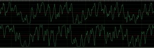

is there actually any real evidence that vinyl releases are any less compressed than their digital counterparts? Why is this taken for granted?
The DR database cannot be relied on for vinyl DR and neither can anecdotes.
Actually it's quite likely that a vinyl master will be more compressed, especially as far as bass dynamics go, since these need to be controlled to prevent wild excursions of the groove. But the problem isn't compression per se, the problem is clipping. Although clipping is usually the result of heavy-handed use of brick-wall limiters, which are a form of compressor, it's perfectly possible to compress a track without clipping the waveforms.
As an example, here's a track from an album released earlier this month, the 'Expanded Super Deluxe Edition' of Imagine Dragons' Night Visions. A friend bought it and asked me why it sounded so bad. Unfortunately, it was easy to find the answer:
All those flat-topped waveforms introduce masses of high-level high-order distortion into the signal. You can attempt to repair it with a 'declipping' program like RX or Audition, though these are simply extrapolating and making a guess as to what's present in the missing data. But I advised him to send the (rather expensive) boxset back as defective. In this case the LP will definitely sound better (unless they've been exceptionally lazy and just dumped the CD master into the cutting lathe).
[Edit] The DR score has never been a particularly useful index. Unfortunately we don't really have a good metric for digital clipping. Looking at the true Peak Level is a slightly better guide, but even that is unreliable: the tPL of this track is only +0.6dB. There's really no substitute for just loading it into an editor and eyeballing the waveform.
Note that the actual peak signal value for this track is -0.6dB - this is a common attempt to bypass the approval process in stores like iTunes which introduced a soft ban on music with a 0dB peak in an attempt to prevent this sort of garbage.
