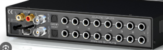

Hello, I've got quite a live looping setup in the works (MPC Key 61, seaboard rise 2, 61-key virus TI2, osmose, microfreak stellar, orba 2, TR-8S, TS7, push 3 standalone, MRCC/XpandR 4x1, RME multiface 2/digiface, 13900KS and various microphone stuff on 2 full K&M stands) but I've got 1 lingering problem. I need to run 5.1 from a Sound Blaster AE-9 (2x RCA, 2x stereo TRS) into 6 of the balanced TRS inputs on the Multiface. These pick up a huge amount of noise, especially with all 6 unmuted. It doesn't just sound like a ground loop, I can hear various patterns which I assume are coming from the many many devices those cables are running by. Unfortunately, the RME audio interfaces will not decode the 5.1 signal over SPDIF so I can't use the digital output on the SB AE-9 for 5.1 that way.
Is there anything I can put in-line, any kind of modification I can make to the SB AE-9 or the cables, etc to achieve a low noise floor on those inputs?
Yes, basically all you need is balanced cabling to the RME to make use of its balanced inputs.
However, this will mean custom cables in your case, notably for the 2x TRS stereo outputs as I'm not aware of any makers of ready-made cables for this specific scenario. Therefore, you'll probably need to make them yourself or find someone with soldering skill. You might get away with a bunch of (stacked) adapters but those just as costly as custom cables and may have issues.
The key point for any cable that converts unbalanced to balanced is that this conversion to balanced must happen directly at the source end.
The conversion itself is actually simple:
You have the hot conductor (like center pin for RCA, or T or R for TRS) and the shield conductor (RCA shell). The balanced cable has three conductors: hot(positive, XLR Pin2), cold(negative, XLR Pin3) and shield(XLR Pin1).
Hot goes to hot, obviously, and cold and shield both go to the shield of the unbalanced source connector.
I'd just by some moderate lengths of off-the-shelf TRS to TRS cables, cut them in half and solder the appropriate connectors to the open ends. Keeping cable lengths short is always a good idea, though.
