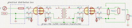

If Ut > 0 current flows thru the person Rk.
i never said otherwise?
So you were incorrect. The fault current is // divided inversely proportional to Risol and Rk.
Wo wo wo... Hold on inversely proportional makes a huge different. you said nothing abut inversely proportional before...
You said: "The fault I is divided between the person Rk and Risol."
and i said:
Green is the current going trough the person as you can see
Rk Rst Rae1 Rae Risol are in series
so no "division"
if Risol is infinite no current will flow trough Rk

The higher Risol the lower Ut.
Exactly this is why an Isolation transformer is saver
The ideal Isolation transformer has an infinite high Isolation resistance (Risol)
High isolation resistance = low current = save
Why? Because it limits the fault current.
If it were 0 current would be much higher similar the solidly bonded (vs impedance bonded) scenario.
More I = high Ut drop across Rk.

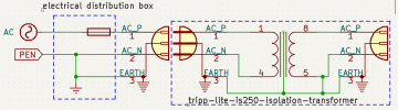

So why do you say the transformer output shuld be connected to PE Ground
A connection means Lowering the isolation resistance or making it ideally close to zero because the connection would bridges the isolation.
Lets further simplify "We" don’t get side traced:
images
a.)If R is High (closes to infinite /open / isolated) the person can touches Output1 OR Output2 and won’t get a shock
only if resistor person touches Output1 AND Output2 he will get shocked.
b.) If "R" is close to 0 (like it is in the tripp-lite) resistor person only needs to touche Output1 and gets a shock.
So why are you saying b.) is better?
images

Consider this scenario.
Ungrounded XFMR (lol)
The sec L goes to G/frame.
What happens to the equipment xfmr plugged in?
What happens if there are other receptacles on the circuit?
Would the CB trip?
If it were bonded would the fault I go thru the equipment xfmr or back to the source xfmr? Would the CB trip?

In this picture:
images
The higher "R" the lower "It" on Output1. we agree on this one?
In this picture:
index.php
If i ever said something else it was a mistake
Pleases link me to and i will edit it and make that i found this mistake tahnks to You're? help.
So the fault I IS in // thru Rk // Risol
You're saying in the picture about Rk is in parallel with Risol?
(took me a moment to realize youre using // as || if you men in parallel)
Because i don’t see it! maybe i wrong. happens some time. can you help me see it.
To me it loos like this:
Can you show me how it looks to you?
Ok i give it a try! I assume the included pictures shows what you describe in the next sentences. Right?
but the picture shows a ground wire going to the secondary N?
So this connection is now shown in the picture is the first fault?
ok the picture shows both situations ?
On the top is youre preferred connection with N and PE connected and on the bottom is the faulty cases. (you assume i’m advocating for)
But the on the on the bottom the outlet is on the primary side?!
Then outlet PE would still be connected to PE? whey shuld it be energized.
I think we coming closer to outre misunderstanding!
I can’t answer your questions before i fully understand the scenario your depicting. Pleases help with this.
So this the first scenario?:
