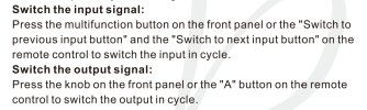

I cannot find the remote. I want to set the pre to in : RCA - out : RCA. I press the volume control. But it seems impossible. The info sheet doesn't say anything specific. !
Seems pretty specific:
Pressing the multifunction button cycles through the inputs
Pressing the volume knob cycles through the outputs.
