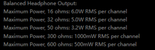

Good work, but Schiit produces a nearly identical product with identical SINAD numbers in xlr and 1.5x to 4x more power.
Checked their website and It seems Magnius have less power in XLR. And Schiit rate their output at 1% THD instead of 0.1% THD like topping, so if they use the same standard the power would be even lower for the Magnius.
And if you use the unblanced headphone output the Magnius has a sinad of 94 vs 120 for the L70.
