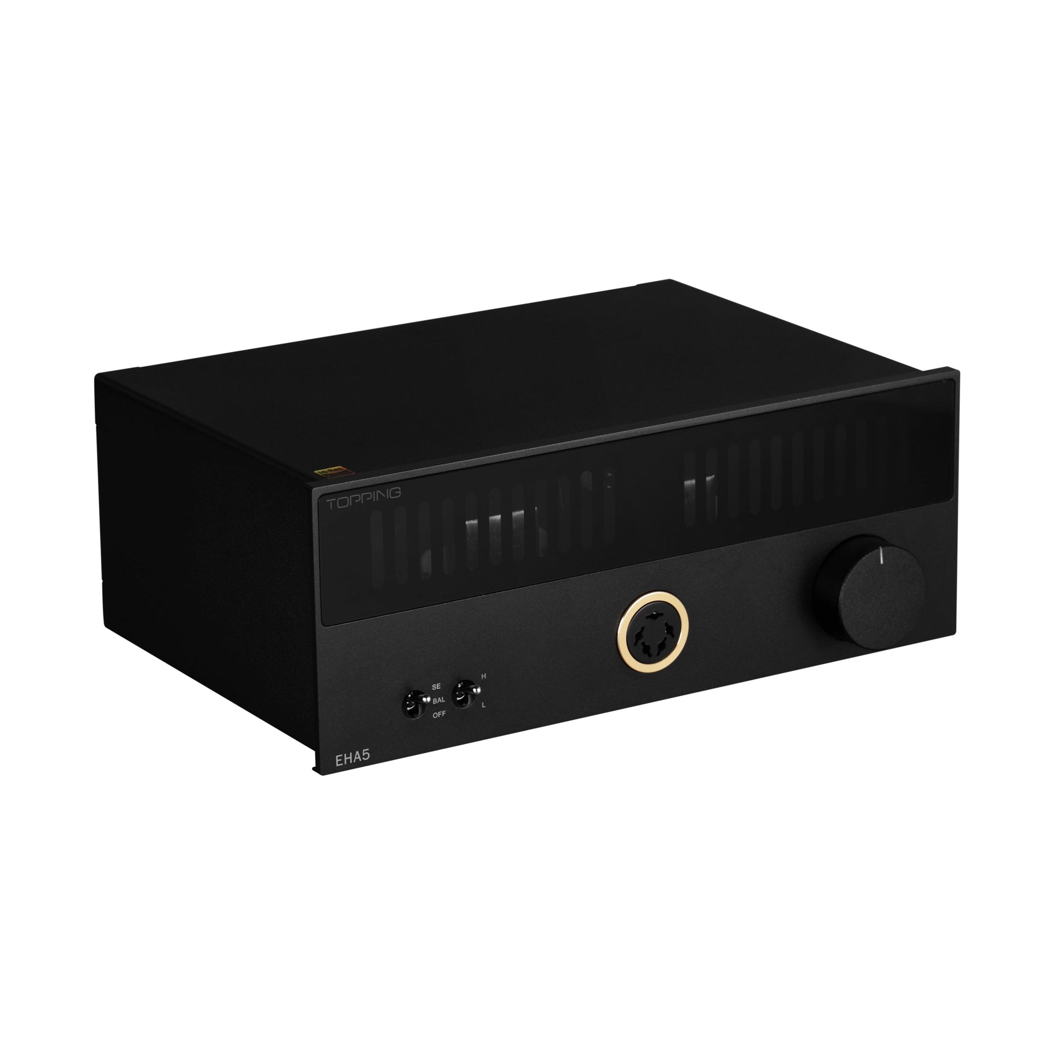

model name: Topping EHA5
design: transformer
gain: selectable, 40db or 30db (or 28db), lowest gain out there, good for high output level DACs
bias: 580v can't adjust
volume control: like other common topping amps, no relay volume
price: $499 or less, or $449
lights inside: for eyes only, tubes for eyes
sound: every amp sounds the same
further update
output level: more than 600v rms under high gain
price not determined

Their way of specifying the test condition is a bit shady, IMHO. Measuring THD+N with A-weighting? Yeah, the power-line related noise would be conveniently attenuated, so are the higher order harmonics. That could also explain the interesting looking THD+N vs frequency curve, which is pretty much the shape of an inverted A-weighting curve. You can argue 'that 's all you can hear', but comparing numbers needs to be done apple-to-apple.
Also, the 'THD+N@20kBW (No-wt)' is questionable. What does that even mean? THD+N @ 1KHz with 20KHz measurement bandwidth, or THD+N @ 20KHz with an unspecified measurement bandwidth? Either way the result is significantly lower compared to a well-built DIY amp such as the KGSSHV Carbon or Blue Hawaii. The FFT and multi-tone plots are the telltale of the amp's linearity.
The 80uV noise is good but not something worth bragging about, given the low gain of the amp.
Frequency response: 20Hz-40kHz (±2.5dB) means the highest and lowest point across the measurement range can be as large as 5dB apart. Go figure.
The interesting dip between 10kHz and 20kHz on the frequency response curve indicates that they need to do a better job calibrating the high voltage attenuator in front of the AP.
Thank you for your analysis! Would this amplifier be clearly inferior to a Blue Hawaii / KGSSHV Carbon? I think it's odd that it uses a small wall-wart versus the other two needing some serious watts from the outlet. However, there could be a situation here where it's analogous to Class D amps; they are measurably superior in every way to big, heavy, and hot Class A or A/B amps barring preferences. I do not know enough about electrostatic amplifier design to understand. I can tell you that my Purifi-based monoblocks sound outstanding, and I'd put them beside any megabuck Class A or A/B monoblocks.
