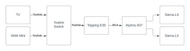

Hello all, long time lurker, first post. The image below shows the proposed setup I am trying to achieve. To be clear I want the ability to have control over specific channels delay and parametric eq, for properly integrating a subwoofer, hence the miniDSP SHD. But I also want to use RME for output switching purposes as well as loudness and easily adjustable tone controls.
One question I have is, exactly how do I connect the miniDSP SHD to the RME ADI-2 Pro FS R BE? I assume using AES but i'm not sure how that works, and the AES port on the RME seems different?
Another question I have is whether the configuration mentioned above is possible with another device? Perhaps the miniDSP Flex Digital or the miniDSP SHD Studio - saving me quite a bit of money. If so how do cable all this up.
"...the AES port on the RME seems different" are you using the dongle that comes with the RME? That will provide a standard XLR connector for AES-EBU inputs and outputs.

Anyway, yes you can connect the ADI-2 to the SHD via AES, or via Toslink.
For AES, you'll need an appropriate adapter cable.
You can use other miniDSP products as well, doesn't have to the the SHD.
To be clear, I don't actually own these products yet. Was simply theorising. I have just watched an uboxing video of the RME and seen the adapter you are referring to, the 9-pin-D-sub to 2x RCA female and 2x XLR Male and Female. So would connecting the RME and SHD be as simple as RME -> 9Pin to XLR Male -> SHD AES EBU port?

Thank you for the warm welcome :D Appreciate the suggestion, you're right, much more readable.
*Edit - Assuming I wasnt to use the miniDSP SHD. Could this configuration work for the proposed setup? MiniDSP 2x4HD Toslink IN (DSP) -> RME Toslink OUT (Preamp) -> RME Toslink IN to source?

My apologies for the confusing chart. As stated above, in this proposed setup, the RME is acting as a preamp I guess. For the purpose of quick source switching, volume and tone control, and the loudness feature.
I have just done some reading on the this forum and the RME forum and here is an updated setup:
Can anyone confirm whether this would actually work and function according to my original idea?
It should work.
Do either the TV or the WiiM Mini have a SPDIF out as well as Toslink? If so you could connect one to the RME with SPDIF and the other with Toslink and do away with the Toslink switch.
Wait a minute, the MiniDSP 2x4 HD only has RCA out:
If you're using a MiniDSP SHD, I'm not sure that the RME DAC is necessary, unless it's for the headphone amp.

Digital connection between ADI-2 and SHD is plug and play, using either Toslink optical, coax digital or AES digital. The ADI-2 has a breakout cable with coax (RCA) and AES (XLR) connectors.
Yeah I realised as I posted my comment but couldnt be bothered to change the flow chart hehe. I would have to use XLR to RCA adapter if I was using the 2x4HD.
RCA -> XLR cables are fine, but you may want to consider making your own out of regular XLR cables, to avoid mains hum and other ground loop related noises.
