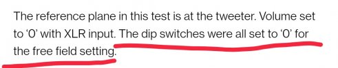

Edit: Oh and keep in mind that the preset I linked is only valid if all dip switches on the Kali are left at default, as that's how the speaker was measured:

Awesome, good to know. That makes it easier for me actually. Since I’ll be running Dirac for room correction anyways, I’ll just leave all the dip switches at default, correct the speaker itself a little with these PEQ settings, and then correct for the room with Dirac.
