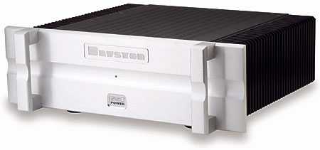

I have a Bryston 4BST that I've owned for 15 years. Got the caps replaced last year. I still love it -- likely to be the last power amp I'll own until I'm forced to downsize. It will have no problems lasting another 20 years, IMHO. The Rotels of the era can be similarly long-lasting.
