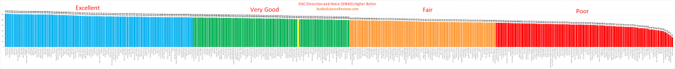

The review of this DAC is dated February 2019 with the price then of USD $260 - quite expensive when put up against DACs that currently cost less and may have improved headphone performance and specifications. Attached is a copy of Amir's most recent ranking of measured DAC performance. The Aune is "long in the tooth", and still in the "blue" zone, but there is better "value for money" to be found. The headphone amplifier graphs for the Aune are not particularly great. As a guide look at the Topping site and then search out the product reviews on ASR. This is a good first step, and there are products from other manufacturers that offer similar DAC performance with improved headphone amplifier performance at less cost. In the Aune review Amir writes "ideally we would want to see 2 ohms or less" for the output impedance of the headphone amplifier.

Jimster480
Jan 26, 2018
2,896
2,058
Tampa Bay
Welcome to the forum and the usual range of opinions.
Yeah definitely not a bad device from some years ago. But definitely not worth the full MSRP today considering what is on the market. This is especially true for the amp section as you had mentioned.
