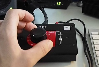

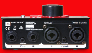

You may wish to invest in some kind of External Monitor Volume control, so you don't have to use or 'mess' with how you have Davinci set.
Something simple and Passive like perhaps JBL's 'Nano Patch' would be a great idea, and is quite affordable, tracks well and takes up little desktop space.
Been using mine for ages and got it unused cheap via eBay.
JBL Nano Patch+
