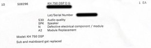

The first time we encountered the issue, we contacted the seller, and the subwoofer was sent to Sennheiser for warranty repair. The report indicated that both the subwoofer and the mainboard were replaced. However, a few months later, the rattling returned under the same conditions. We sent the subwoofer back again, and this time the woofer itself was replaced. After several weeks, we received the unit back, but it seems that there is still some rattling noise when playing a low frequency signal trough it loud enough.
So, it was okay for a few months after the first repair?
We sent the subwoofer back again, and this time the woofer itself was replaced. After several weeks, we received the unit back, but it seems that there is still some rattling noise when playing a low frequency signal through it loud enough.
