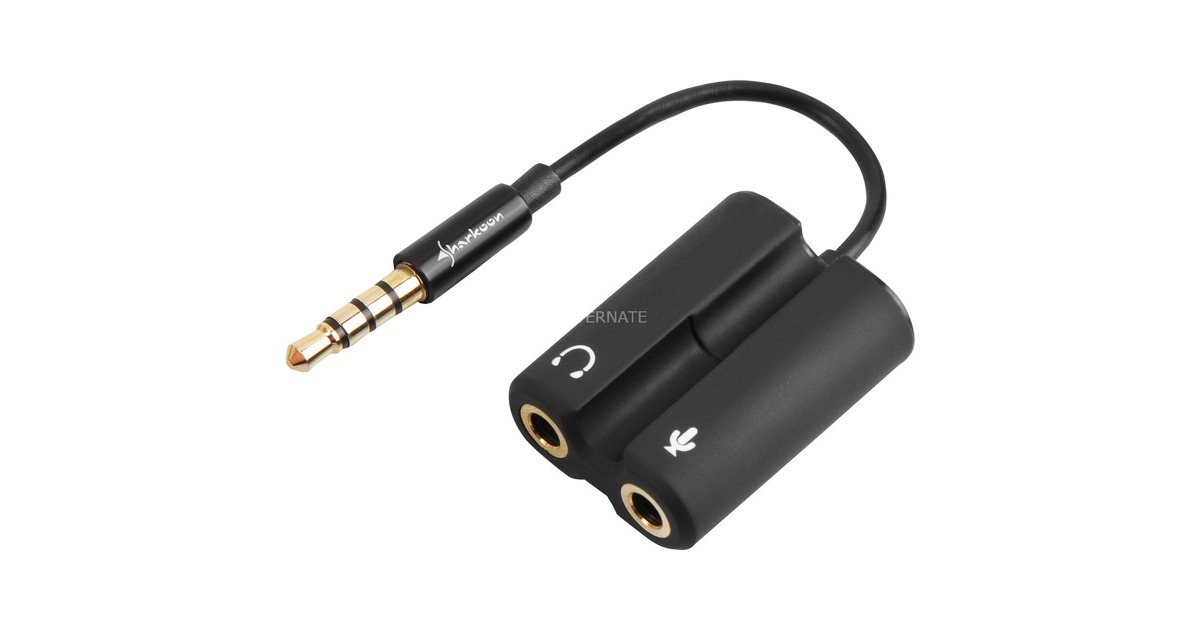

Also, the headset has a 3.5mm classic jack and same for the mic. So it has two (3.5m??) classic jacks! I guess I can buy some cable for the mic seperately?
It's a headset splitter:
Plug your PC38X into the Apple dongle via one of these and it'll take care of both the headphone and mic.
