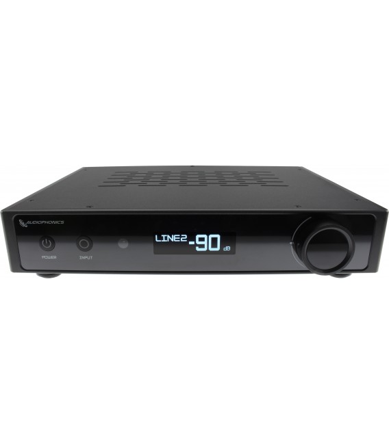

Audiophonics has a preamp that looks like a good alternative to this one:
But that's only 2 channels compared to 6 of this one.
Well, it has 2 outputs and 5 inputs. It also transforms from SE to balanced and the other way round.
And the price is 350€.
The use case is so different. No one looking for a 2 channel preamp is going to be looking at the Lundahl 6 channel preamp, and no one lookung for a multichannel pre will look at the Audiophonics.
