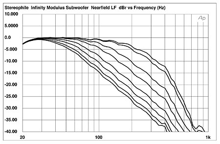

I am not sure if you are familiar with frequency response graphs but maybe this will help you visualise the effects of different low-pass filter settings (the curve which extends further to the right is produced with the low-pass filter set to 210Hz, the one which produces the narrowest range is produced with the low-pass filter set to 50Hz):
Infinity Modulus subwoofer, nearfield response with low-pass filter set to 210Hz, 175Hz, 120Hz, 90Hz, 70Hz, 60Hz, and 50Hz.
source: https://www.stereophile.com/content/infinity-modulus-loudspeaker-modulus-subwoofer-measurements

Not many recordings have very audible sound below 40Hz. If your subwoofer is only reproducing the 20-35Hz range then it is likely that it won't be audible. That is why you perceive the 85Hz crossover frequency as "lower", although in fact the sound/range is louder because it is reproducing "higher" bass frequencies (a wider range).
As you widen the range reproduced by the subwoofer its "presence" becomes more noticeable, particularly if the level/SPL (dB - vertical scale below) is set higher than that of the main speakers of if there is overlap of frequencies (Hz - horizontal scale below) reproduced by both speakers and subwoofer which will generate a "bump" at the crossover frequency.
