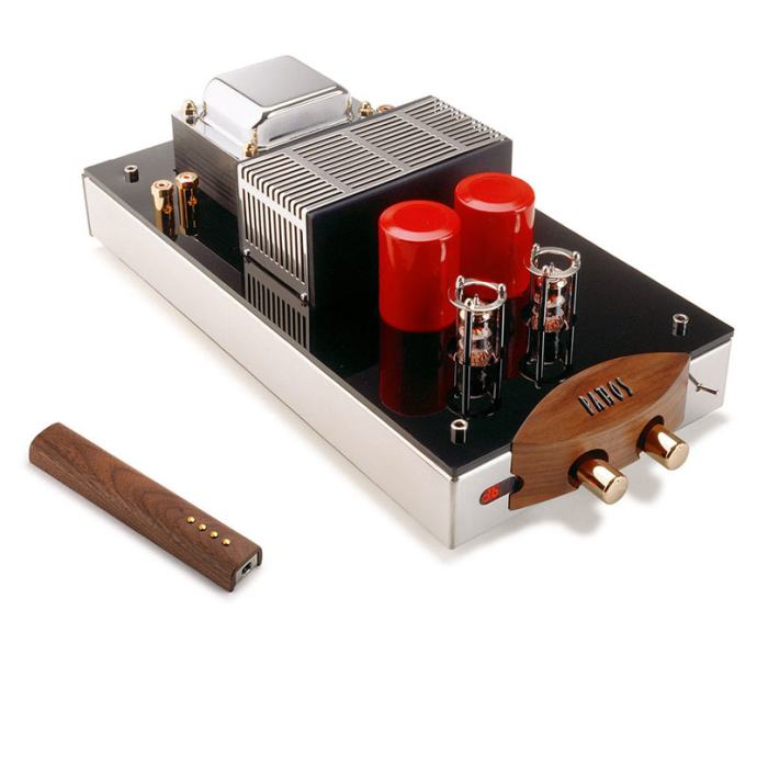

Wow, hybrids are my boy dream! How do you like it? Which tubes do you use?
Recently I found this one and can't stop thinking about it:
