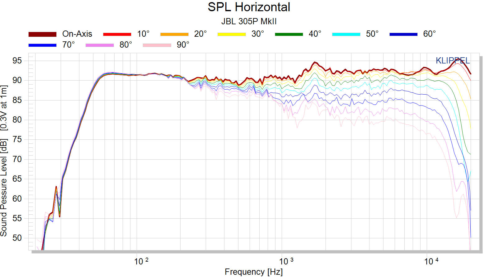

CTA-2034 / SPINORAMA:
Early Reflections Breakout:

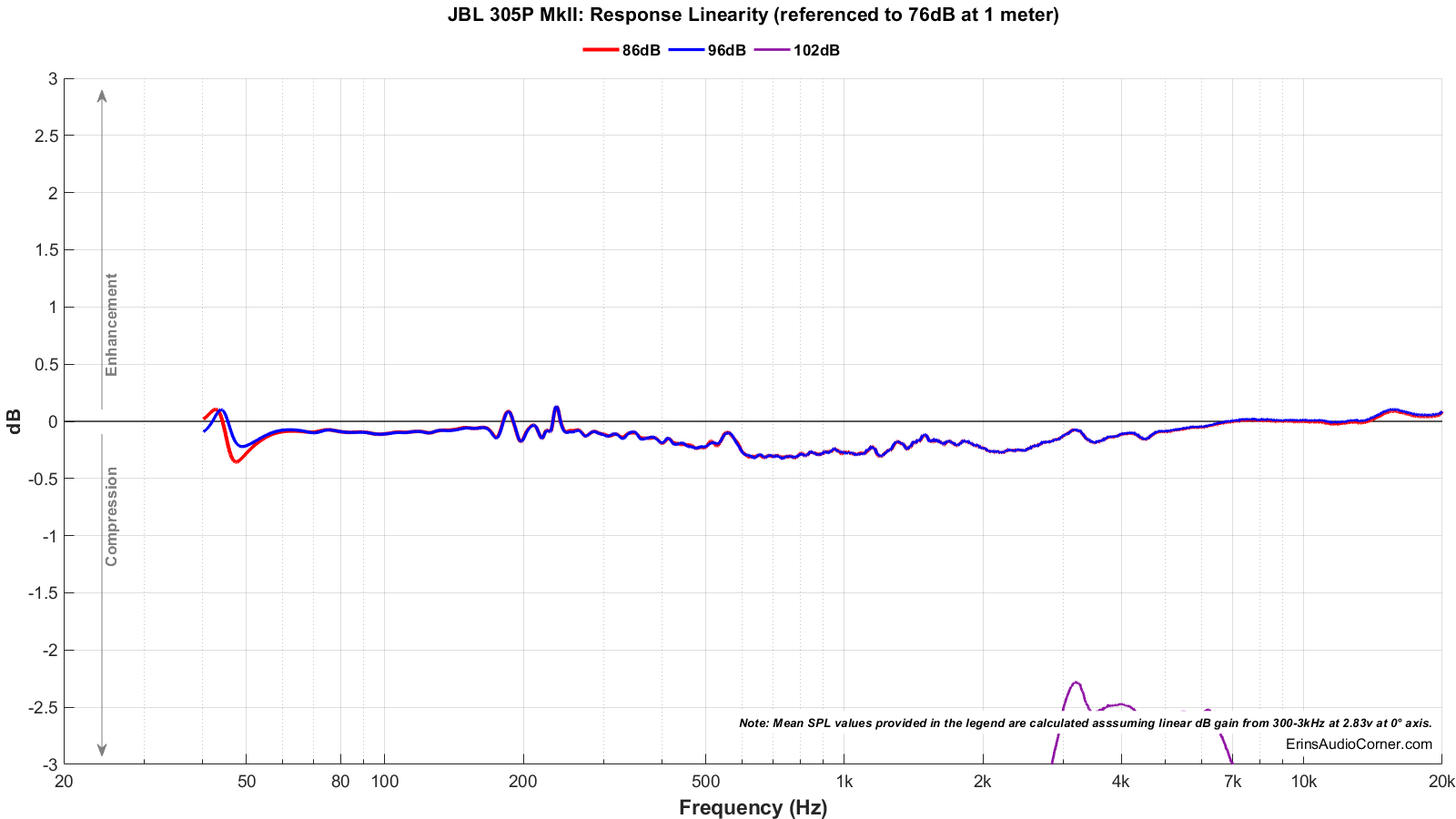

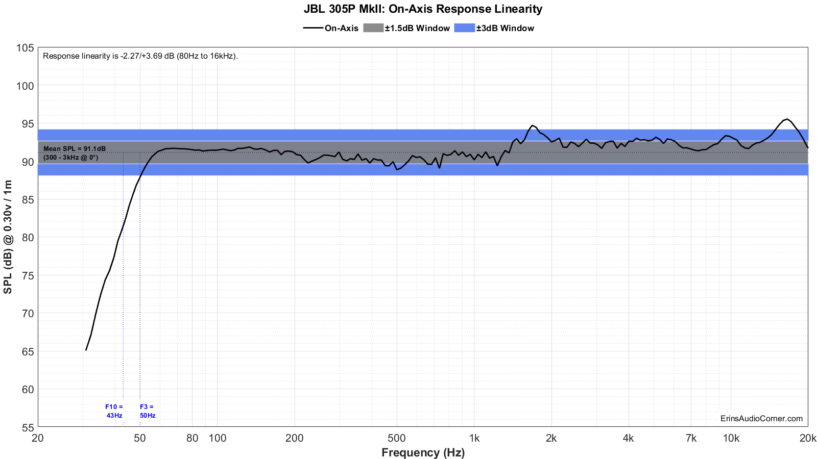

On-Axis Response Linearity

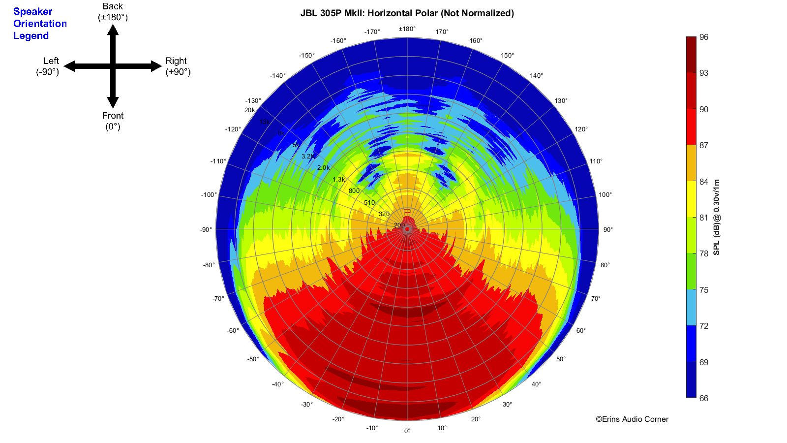

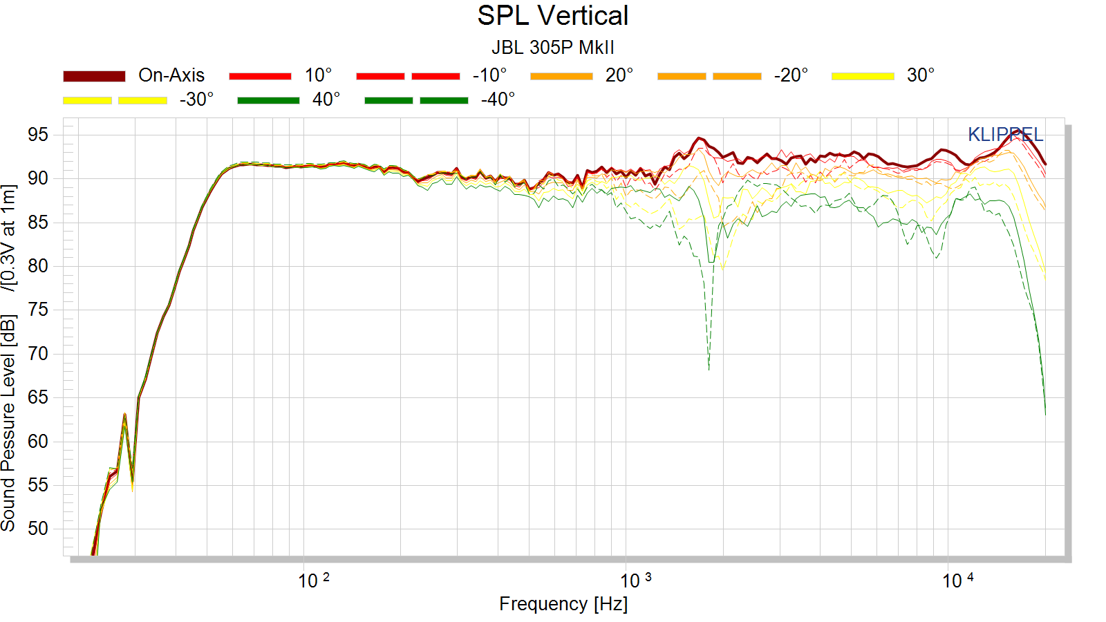

“Globe” Plots

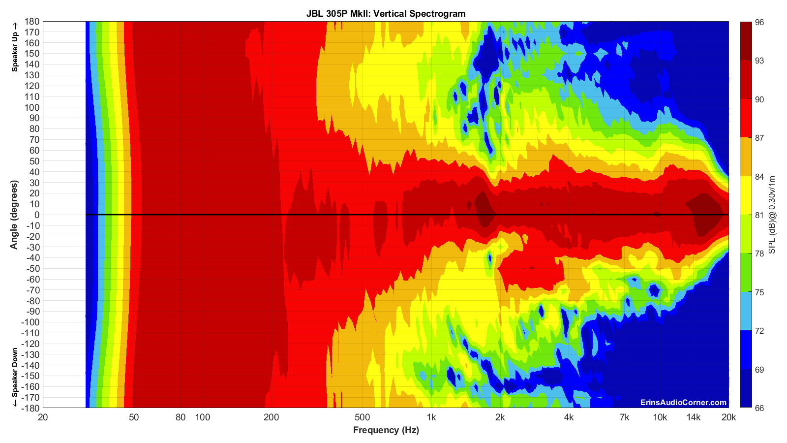

Vertical Polar (Globe) Plot:

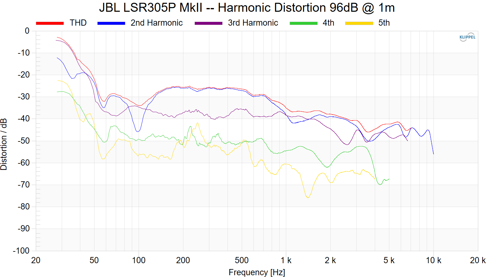

Harmonic Distortion

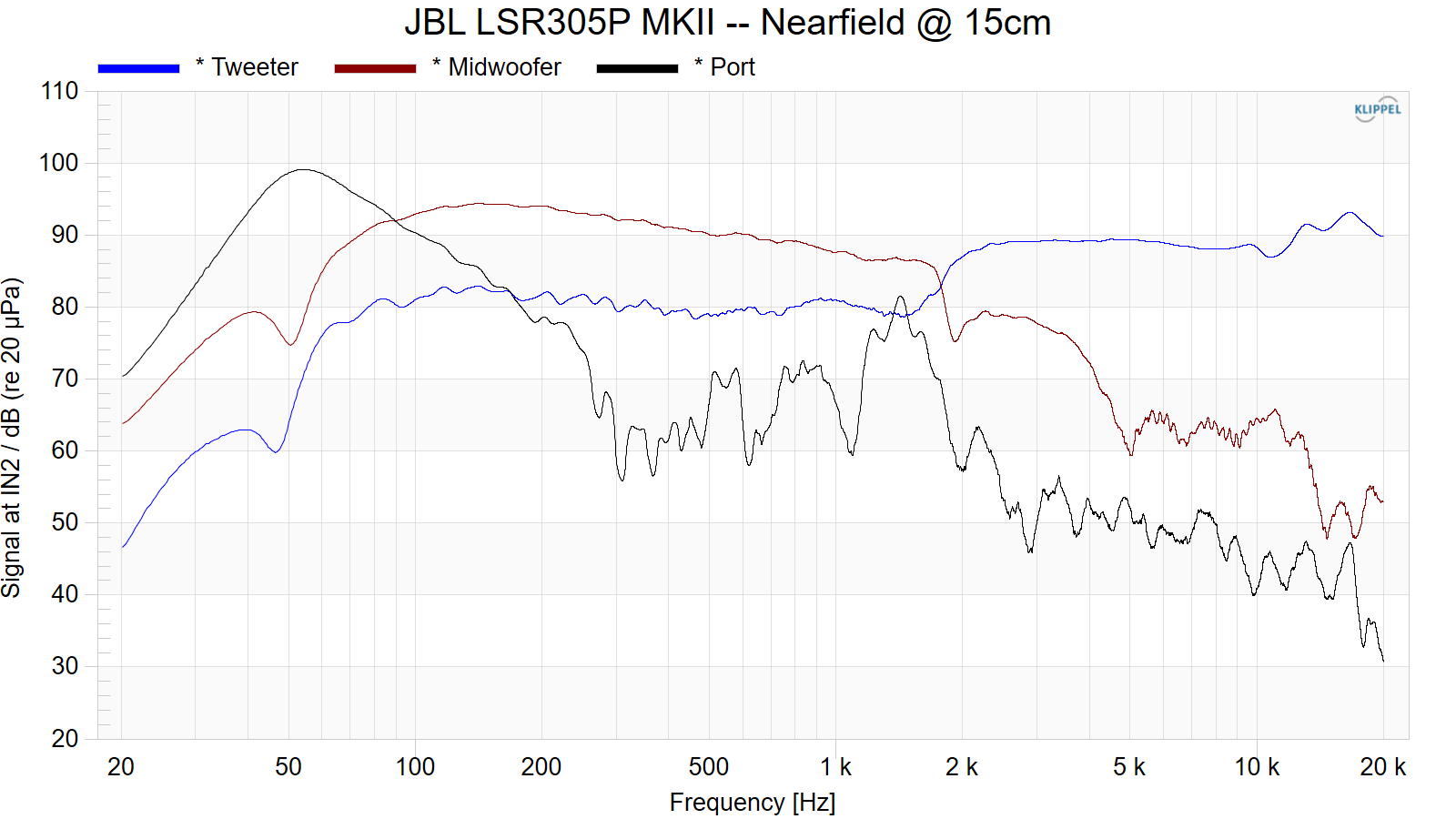

Near-Field Response
Nearfield response of individual drive units:

Based on my results above, it is obvious the output is limited significantly somewhere above the 96dB @ 1m output level. I haven’t confirmed with JBL if this is a built-in limiter, though, I assume it is.

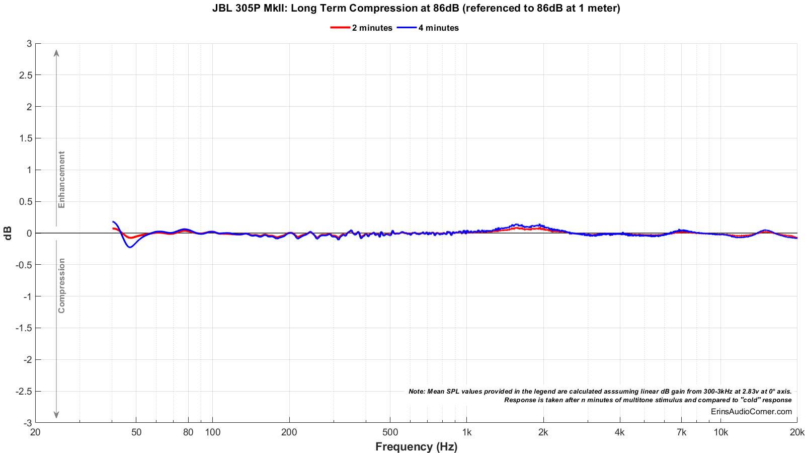

Long Term Compression Tests

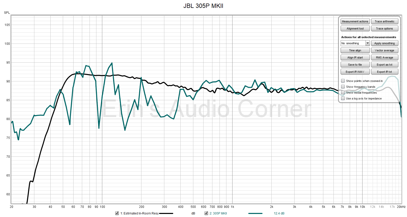

In-Room Measurements from the Listening Position
Below is the actual measured in-room response (with no DSP correction). This is a spatial average taken over approximately 1 cubic foot. The speakers were placed approximately 1.2m from the front wall (not the cabinets; but the actual wall). The listening position was primarily at 1.5m but for this test I measured the response at two different distances from the speakers.
Black = Predicted In-Room Response from SPIN data
Teal = Actual In-Room Measured Response from Main Listening Position at ~ 4 meters
As expected, the predicted in-room response and the farfield response (3.5 meter, blue) line up quite well above approximately 500Hz.

Thanks for the review @hardisj! It's interesting to see these again as it was I believe the first speaker Amir measured, so all his refinements weren't in place yet.
The 225 Hz resonance is interesting -- hard to see anything there in the spin other than a small dip (the one at 1.7ishK is obvious). But you can see in MZKM's normalized horizontal plot that there is some clustering going on at that frequency -- just hard to imagine such a small thing would have such an audible effect!
Anyway, seems to me like using a HF shelf above 1.5ish kHz would be a good idea.

@hardisj Re: your compression tests.
2 minutes and 4 minutes in my opinion is hardly 'long term'. At 4 minutes, the magnet structures won't even be warm. The voice coils will shed their heat much faster to cold adjacent pole pieces/magnets. The electronics (amplifiers) will be barely above ambient and any crossover components (in passives) will not be stressed, letalone warm.
These JBLs are a low power system anyway so it probably doesn't matter so much, but when you test higher power (rated) speakers at much higher SPLs, the term should be considerably extended to determine the effects of temperature related compression in a more useful (and related to typical used-case) manner.
But you do live in a neighbourhood and don't want to upset your neighbours.
I understand the concern. However, you could ask ten different people how long they think the test should be run and you'd probably get ten different answers. However, I based my method off a few things:
  • IEC 60268-21 §17.1 has a couple different max SPL settings (depending on short term vs long term). The long term test is 1 minute of signal, 2 minutes rest. I have quoted a portion of it below:
- Excitation time (T): Time = 1 s​
- Pre-excitation time (Tp): Preloops = 59x​
- Stimulus time = 60 s Excitation time + Preloops according §18.4.1​
- Averaging = 1 (Time * Avergaing = T_s)​
- Pause = 120 s according §18.4.1​
- Repeatition = 60 times​
  • Scan-Speak does 28 minutes total of 1 minute on, 2 minutes off. Weighted pink noise with a crest factor of 2dB (my CF is 12dB). Link.
  • My recent discussion with Earl Geddes where he recommended one minute on, measure, another minute, measure.
I took a conglomerate of these and came up with test, 2 minutes, test, 2 minutes, test. I chose the levels because I believe they are rooted in reason. I think 2 minutes of 86dB is close to what people will listen to (when you factor in two speakers in a room). The 96dB is on the higher end and is more of a stress test. Others are welcome to adopt a similar methodology and tweak as they see fit. To date, though, no one is doing anything remotely like this compression test (long or short term). And, IMHO, it is far more important data than distortion measurements (which I still provide, just for the heck of it) because the frequency response is changed and that is clearly audible.
I'm not saying running the test longer wouldn't be useful. I'm saying I don't know that it is entirely necessary and - based on the fact the IEC is less stressful - I like my method more. Plus, it can be run pretty reasonably. It's not just a "better than nothing". IMHO, it's a "rational and useful" method. Call me biased. But I'll stick with this method until I have convinced myself there's a reason to change. If you look at the below graphic you can see that even 2 minutes is enough to change the response of "lesser" speakers:

That's my $0.02 on the subject. As I said, if others want to run a similar test they are certainly more than welcome to change their parameters as they see fit.
It's not about level
and extended testing should be considered as a more typical use case IMO
Well, it is about levels.
At 1 meter:
86dB at 1 meter anechoic for a single speaker ~ 95dB at 1m for a pair in a room.
96dB at 1 meter anechoic for a single speaker ~ 105dB at 1m for a pair in a room.
At 4 meters:
86dB at 1 meter anechoic for a single speaker ~ 83dB at 4m for a pair in a room.
96dB at 1 meter anechoic for a single speaker ~ 93dB at 4m for a pair in a room.
