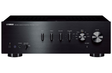

Yamaha A 801 is one example , there are others.
Or the AS301 at about half the price:
