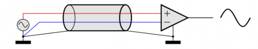

This is the basic cable construction:
Screenshot_20240605-120509_Drive.pngScreenshot 2023-11-23 at 08.38.00 (1).png
To further improve CMRR, you can install a series resistor to match the RCA output impedance:
For more information, take a look at Bruno Putzeys The G Word.
