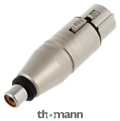

Anything in here?
coaxial-to-AES/EBU adapter
For a similar use case I'm looking at this unit myself.
I'm no expert, but at least one reviewer states that it does the trick for them.
IIUC that is XLR (differential) -> RCA (single-ended). The opposite direction would either produce non-differential signal (which may work OK anyway but the advantages of the differential path are lost), or an active solution with differential line driver.
A correct conversion between single-ended (RCA SPDIF) and differential (AES/EBU XLR) cannot be passive, it requires an active line driver which generates the negated signal for the differential line. That device is a convertor in the other direction - differential -> single-ended which can be done passively (only one line of the differential pair is used). It may work (because there is still a signal difference between signal line and 0V, half the level), but the advantage of using a differential signal is lost (rejection of common-mode signals). It may not be a problem if the line is short, likely you may not even notice it. The differential version uses higher voltage levels but again if the receiver is OK with the low levels of SPDIF, it may work too.
To sum up - it may work perfectly fine, but is not technically correct.
To alternately sum it up, it is technically fine. The differential receiver sees pin 2 (hot) from the sender, pin 1 (shield), and pin3 (cold) both connected to the sender's ground [note, other wiring options are available, it doesn't really matter for these low bandwidth low distance situations]. The differential signal is then received perfectly fine as the difference between pin 2 and pin 1. Maybe not over a hundred metres in an auditorium, but certainly without problem in a house.

seems a bit complicated. maybe i should just use the RCA outs of my JDS 4 and connect them via RCA to XLR to my Genelec, and just use my GLM Kit for Room Correction?
if use it nearfield so my cables are very short, maybe i can get away w/ little to no noise. otherwise I would have to buy a a passive RCA-to-XLR transformer (like Neutrik NA2F-D0B-TX) (not the Neutrik Na2 FP MF that @Rednaxela mentioned, as it's the other way around?)

Well, I do not see how a passive transformer could provide the specced AES/EBU levels from SPDIF. IIUC SPDIF is specced 0.5V to 75 ohm, which is 3.3mW of power. This power, transformed to 110 ohm of AES/EBU, can at most (with 100% efficiency transformer) generate 0.6V which is way below the specced 2V minimum for transmitter (2 - 7V). While there are passive transformers, e.g. by Neutrik, I do not see how they could generate specced AES/EBU signal from specced SPDIF signal. E.g. a discussion at https://www.audiophonics.fr/en/vari...r-spdif-coaxial-75-to-aesebu-110-p-16821.html - translating the french response:
Message from Audiophonics service
Do not use coax to AES cords. They do exist but do not correspond to any standard and do not respect the necessary impedance. This product is active and has an internal battery, it is indeed necessary to recharge it.
So IMHO it still holds - it may work perfectly fine, but is not technically correct, even if there was a transformer inside (which almost certainly is not).
