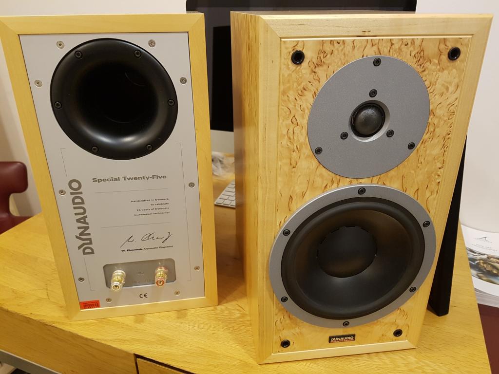

Seriously thinking about side-grading from the Contour 20 to this for purely nostalgic and retro fashion reasons.
Not, it's not rational in the slightest, but neither is my turntable or reel-to-reel deck.
It tickles my homage button for either various Dynaudio speakers I've owned over the last 10 years, or ones I wished I had owned when I was younger (e.g. Special 25).
