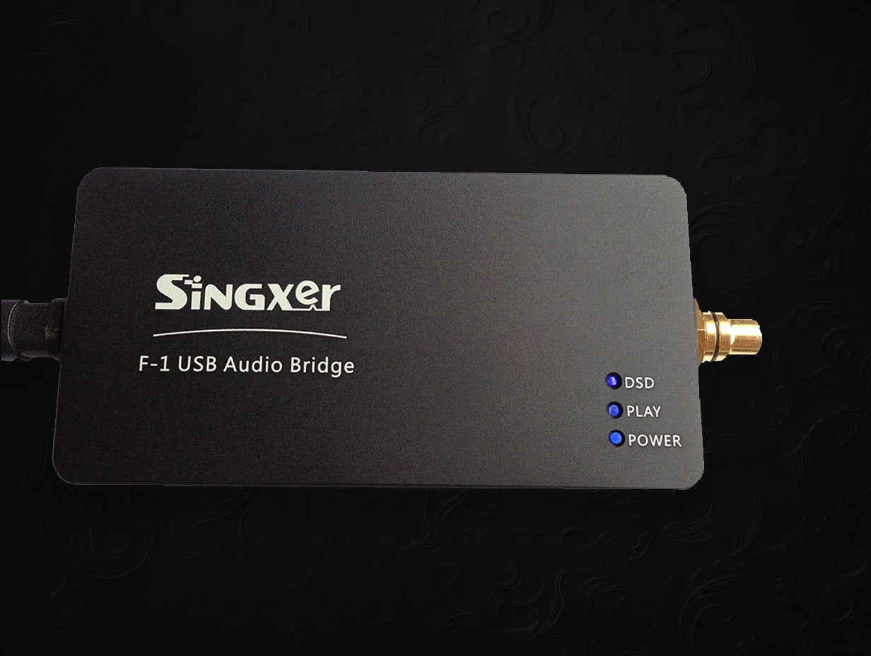

A USB-S/PDIF bridge is a useful tool for many purposes.
For example, some game consoles only support UAC1, so a UAC2 DAC cannot be connected directly. Or the USB input is taken by another device, and S/PDIF works as another input. Or the S/PDIF signal can be recorded in order to transmit digital sound from one device to another.

There's some budget ones:
MiniDSP had the NanoDigi but seems that's replaced by the more expensive Flex Digital.
