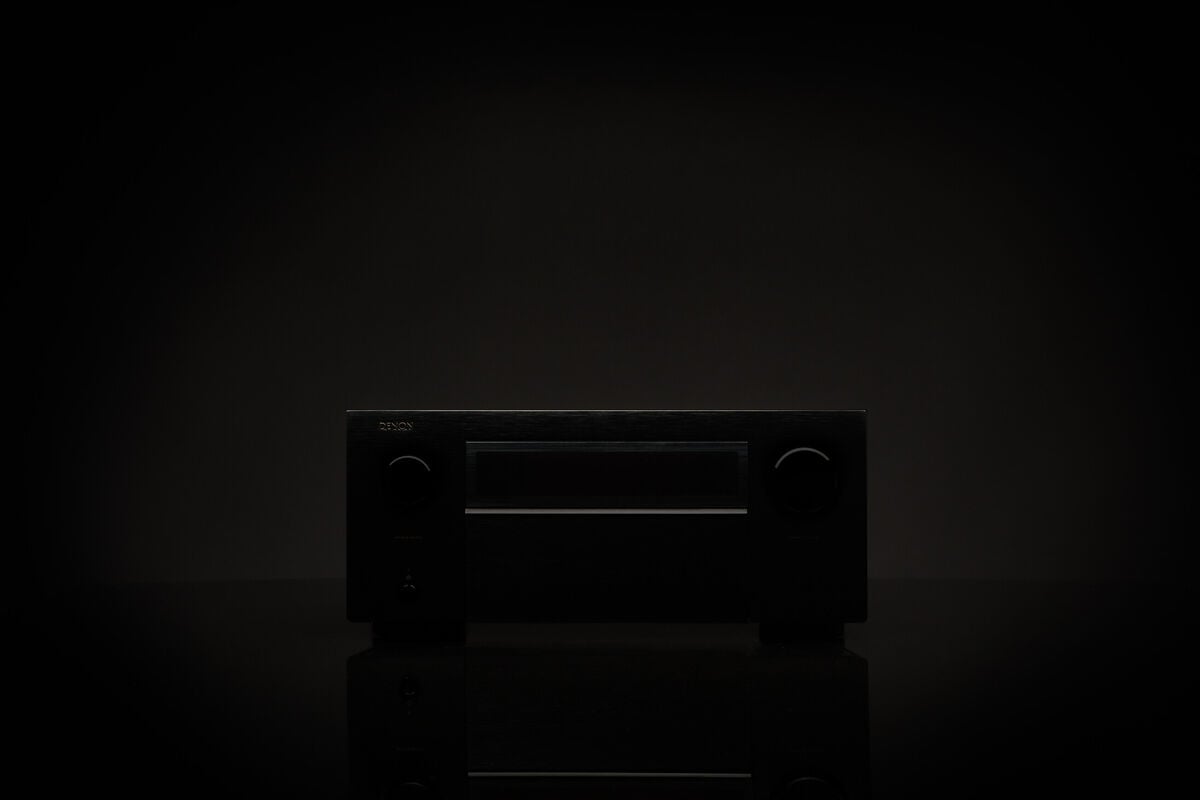

Was curious if Denon 3800/4800 would have DLBC but didn’t see. I am still on a quest to find the simplest solution for 2.4 stereo and haven’t found it yet.
Any day now. People are reporting end of month, to get the firmware update.
