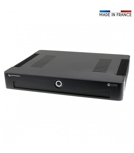

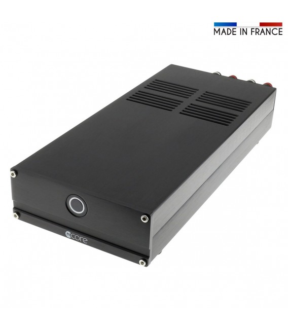

I'm considering pairing a WiiM Pro + with either one of these two Hypex Ncore amplifiers :
The first is described as a "stereo/large single mono dual amplifier [...] based on a duo of Hypex NCore NC250MP modules"
The second, as a "stereo amplifier based on an (single, I presume) amplification module Hypex Ncore NC252MP"
I don't have the technical knowledge to understand the difference in practical use, can someone explain?
I've asked Audiophonics directly and they left me confused, it seems like they are saying the sound difference would be imperceptible, and that one is double the price as the other because it's more expensive to produce...
Are they made for different usages?
I like Audiophonics, but they must understand how to present products, unless they go for a technical niche market.
As long as they probably have a waiting list, positioning and presenting products properly for lay clients will not be a priority.
