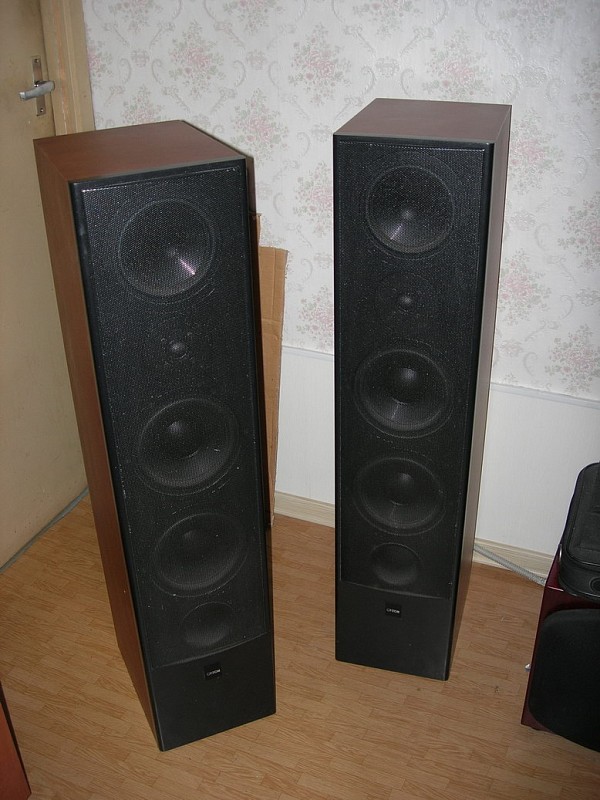

So the Cat dragged home a pair of Canton LE 109 - free of charge! :)
Picture shamelessly stolen from the interwebs:
It seems they were made very early in this century. Two 200mm bass units, Front facing port, "fabric" tweeter and midrange on top.
I have been using past hours to compare them with my Focal Aria 926. Focals seem a tad bit more sensitive so direct comparison isn't accurate without level matching. It's late in the evening and I am in a condo and don't want to play loud so my testing is limited so far. Let's just say the Cantons are NOT disappointing and they are giving my Focals serious competition. Sweet and clear vocals and strings, plenty of detail ...
PErhaps I will update when I can feed them more watts.
Are they really competitive? The focals are ~2000€ and all Canton LE 109 I found on eBay were <200€. I really hope they are competitive :)
Can't say for sure yet. First impressions can be deceiving and I am stuck at low level , but so far so good.
Ok, for the past two hours I have been trying to compare the Cantons to Focal 926 - and during this time I had your question in mind. The short answer is yes.
It's difficult to switch speakers fast enough for comparison, so the method I use is to put Canton on left channel and Focal on the right, then flip the balance on my computer left and right for quick comparison on the fly between speakers. I am using my Denon 1600ne to drive them.
The main difference is a bit surprising perhaps - albeit with smaller bass cone area the Focals produce a bit more upper bass. If memory serves me Amir has mentioned this changes the coloration of the sound and many find it more pleasing than "neutral upper bass". I suspect this is a feature of the Aria line from Focal some of us like about them. However when I dig up sub-woofer tests tracks it clear the Cantons can do more in the bass department, they go deeper than the Focals.
On the flip side - the Cantons sound a tad more clear and bright. I happen to like that, but YMMW. Keep in mind I can't hear anything above 14khz.
I would describe the Cantons as "neutral", they create great soundstage, they would benefit by subwoofer (just like the Focals) To my ears they sound fantastic. And I am pretty sure if one doesn't like the tonality - they can do what you want with EQ and do it well. I suspect the rock&roll crowd would want more bass and perhaps less midrange.
