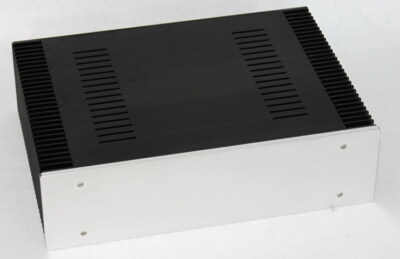

Ok, just to give you an example ...
Note: Not that I'm recommending this... but here's a case where the front and rear panels come off.
This way you can replace the rear panel while keeping the rest the same. I know you have to run the numbers and will also consider other issues. But just as a design idea.
[edit] this is another similar case.
I think this case looks a little cleaner, see if your guys can do this?
The original cases I used had an independent front and rear design. But for various reasons I switched to the cases I use now.
