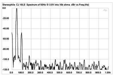

Stereophile's measurements of the 16LS from 2001 can be found here:
The distortion in the 16LS output varies a lot depending on the input impedance it's seeing, but I'd assume the LA4 has a fairly high impedance, though this isn't listed on their website.

For my part the the differences are predicted by measurements: thanks, @charleski, for the link to JA's CJ measurements. There the salient point is the very high 2nd order harmonic. What is also comment-worthy are the relatively low higher order harmonics beginning, maybe surprisingly, with the 3rd order.
