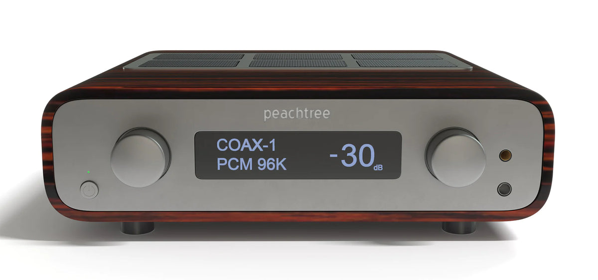

The 'original' Peachtree Audio 'Carina' integrated amplifier has an I2S input. This variant has zero analog inputs. It is no longer in production. Peachtree Audio is selling 'recertified' samples from their website:
bit pricey just to give it a try, but good find for sure.
