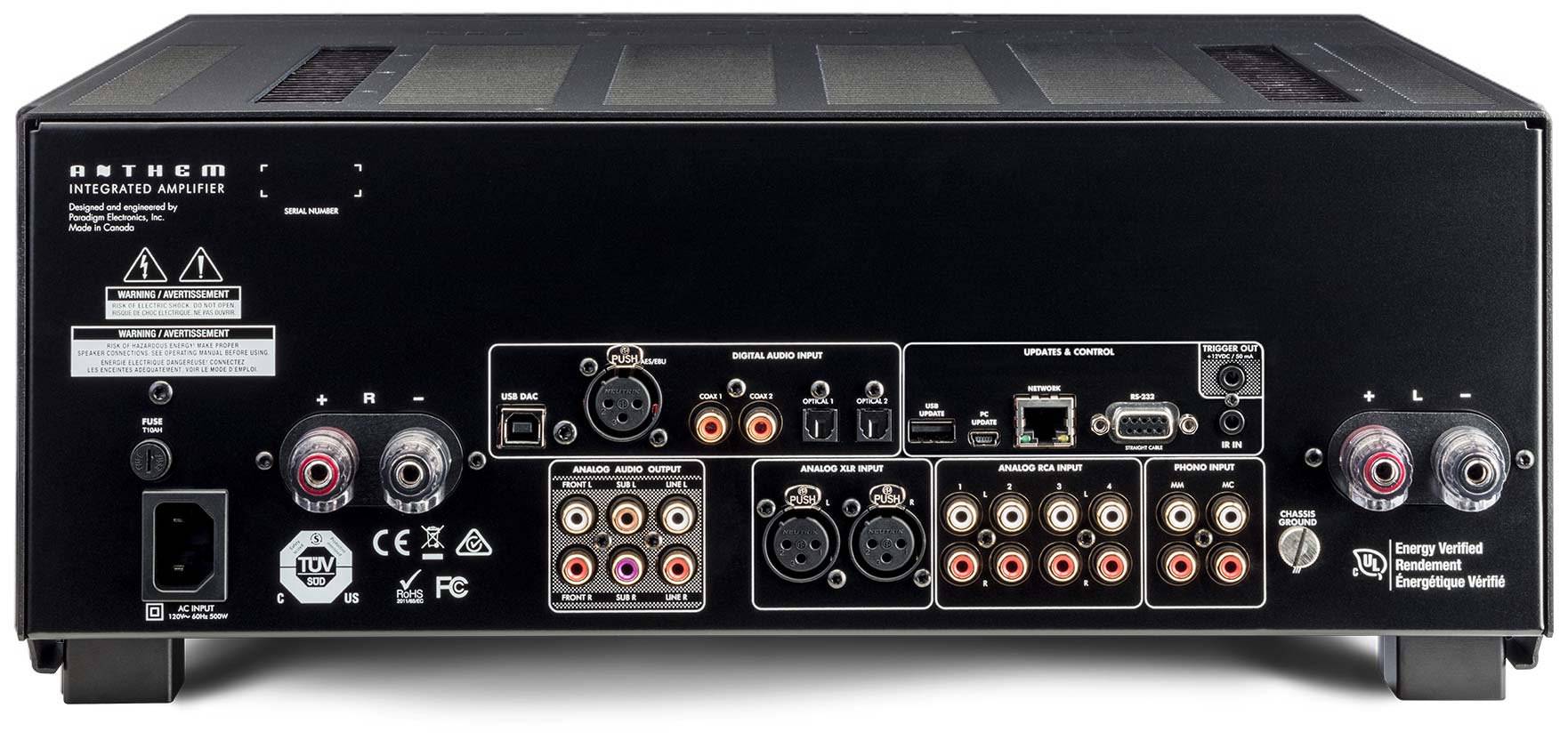

Here's a list of some amps and preamps with proper support for subwoofers:
That's a really handy list, thanks.
The Marantz M-CR611 and M-CR612 (and perhaps others) integrated network receiver CD players also support this. Eg:
