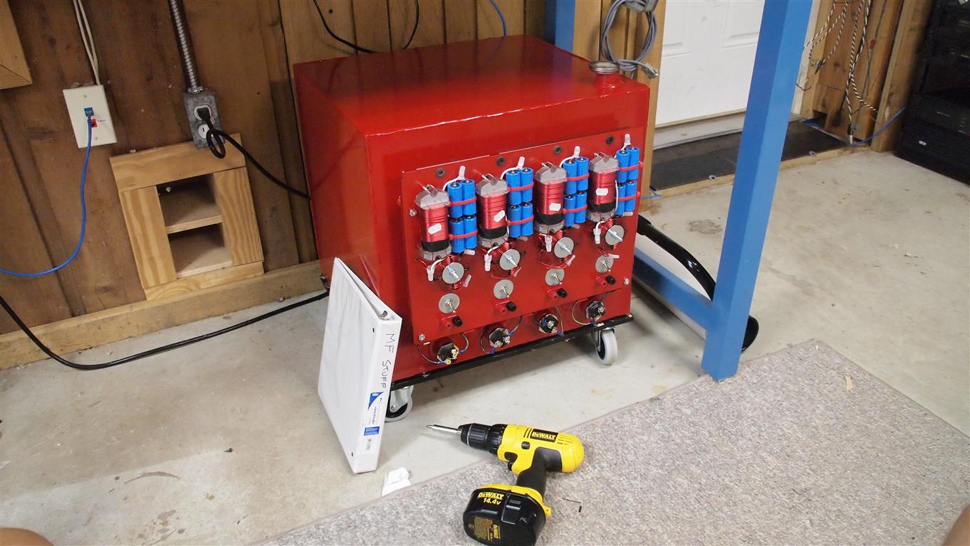

Should work. Just don't touch it during use as it may get quite hot depending on how much power you pump into it.
Well the 545 talks of 10 minute pre-conditioning at 1/3 power/ 33watts, and the 5400 at full power 120watts for 5 minutes. In any case I thought the 300 watt spec of the 8 ohm resistor to be sufficient but yea probably not a good idea to touch it in any case. LOL

I don't feel good at all cooking the thing at full power for 5 minutes. Recipe for potential damage. Just run a bit till it is warm and good and then set it.
setting amp bias needs to be down slowly and over time/temperature, and if its fairly close, I would not touch it given the age of the pots etc
Yes I agree, thanks. I wonder how far off from the spec'd 7mv you'd live with before an attempt to adjust was made? I'm thinking +or- 1/2mv would be called good enough but......... Never tweaked SS amp bias before. I did my VTL tube amps a couple times a year and they could be held to a fairly stable 300-325 of the 300mv spec?

Theres bias and offset, offset at the output of the amp, I would say if it is within plus or minus 10mv its fine, up to +/- 20mv as well would not touch. Bias is setting the idling current in the output transistors, consult your service manual for both adjustments. Solid state should hold its settings for decades and be within spec. Millivolts of offset will not even get passed your crossover components in your speakers, its not that important until you deal with headphones.
Thanks bud. Offset is self-adjusting. Bias spec for the 545 is 7mV, +/- 1mV. We'll see how they measure
