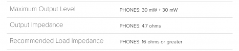

I have never thought about using an IEM - stumbled across this review and I just had to get them. I'm sure that I would end up loving these for casual music listening at home - on the go I prefer wireless options, but the main question is how well would these work with my BOSS KATANA:GO?
Can't lie, I haven't been that excited for something that cheap in a while!
This thing costs less than my usual Friday night takeaway.
Should work just fine:
