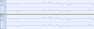

I've just downloaded two versions of a song: one was ripped from a CD, and the other was downloaded from Ototoy. When I check the audio MD5 in foobar2000, they appear different. However, when I use DeltaWave to compare these two files, it states, 'Files are a bit-perfect match at 16 bits,' and they look the same in the delta spectrogram. This has left me wondering if these two files are actually identical. Additionally, I'm not sure if DeltaWave labeling them as a 'bit-perfect match' means they are the same.
Update: Thanks for your suggestions, I've tried the null test by Audacity
These are original audio md5 of them, one was ripped by each and the other was web-downloaded.
And then let's compare them in Audacity
That's right, these two files have different leading or trailing with value 0.
Now I'll truncate silence.
They look the same, then invert one and mix them.
Beautiful straight line. But let's check again the audio md5 before invert, just after truncate silence.
Now they are finally the same. It just demonstrated again the reliability of CD and EAC, which may already be automatically performed by Deltawave. This method may also be used to test those called 'HI-FI CD rippers'.
Thank you guys.

By design if the MD5 is different, they are different. If one has 1 more sample leading or trailing with value 0, they both of course sound totally identical but do have a different MD5.
You might try a null test using any audio editor.
If deltawave says they're identical, then they are probably identical. What could easily be different is a different number of leading / trailing samples. One more fraction of a millisecond of silence in one of the files will give a different MD5 value, so if they are ripped from different sources, you should probably expect MD5 to not match.

Different CD drives have different offsets. This means they can rip the identical track but as noted above, the resulting file may have different durations of silence before and/or after the music. This is the most likely explanation here, though as @Vincent Kars notes, you can be certain (well, close enough to certain, anyway) that the audio is the same by running a null test in a free app like Audacity.
In fact, if you load both versions up in Audacity, you don't really even need to run the null test - just lining up them both up together in Audacity so the musical data for each one is aligned with the other down to the level of the individual sample, you can scroll left and right and examine the silence at the beginning and end. If you see that either one has more or fewer samples of silence than the other one, you can be almost certain that's the culprit for the different md5 hashes.
