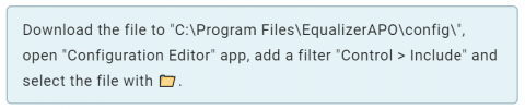

How to import the presets into EQApo is explained here:
  • 770 to G Pro X Presets.zip
Amazing, those really did work! Thanks for sharing very much appreciated!
