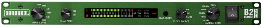

Nice work, appreciate it. Read your blog, have to dig in a little more. Tried to explain this topic to some young fellas at a venue, with a Allen and Heath digital mixer - to no avail.
