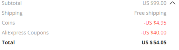

I placed an order a week ago, so when I receive it, I will write my opinion. Usually, delivery to my region takes 2-3 weeks
It also cost me much less than I thought, with all the promotions and coupons it came out to $54. So, I think it's a great purchase for that price :)
