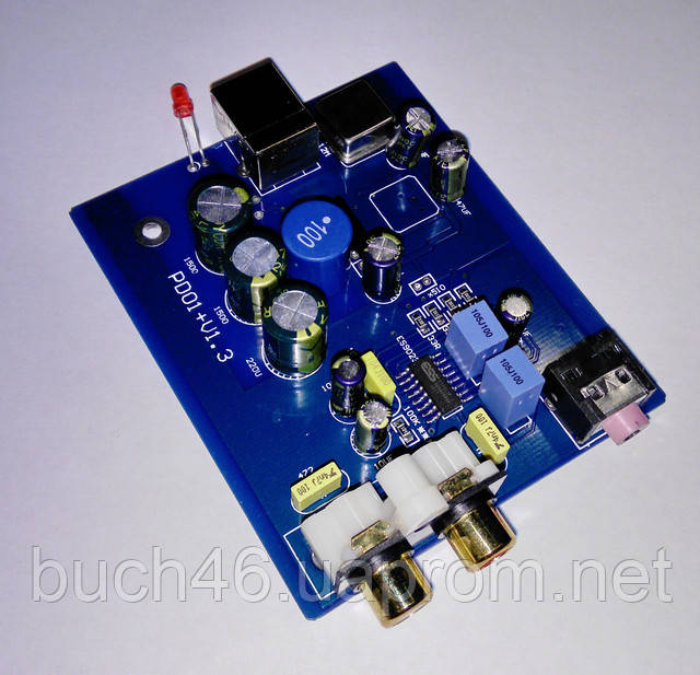

I have involuntarily conducted an interesting test today. My mini PC's power supply is giving up the ghost, it started humming today, and simultaneously significant hum and static appeared in the audio out. It's clearly a power supply noise as it's not affected by any volume controls (including the physical knob). And I can tell you that the power supply noise rejection ratio of DX1 is not the best. Surprisingly, it's a lot worse than this cheapo DAC ($16 on Aliexpress, $25 with a case):
But the integrated Realtek is way way worse than DX1.
