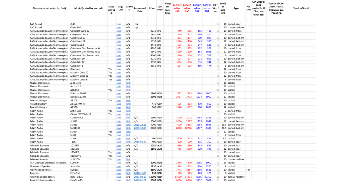

You want to look at the ‘sweetchaos’ subwoofer comparison see
