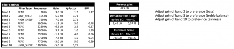

Hey all! Sorry for hijacking an old thread, but I have the very same setup akg-712 pro with Fiio K5 Pro (non ess). Sometimes I feel it lacks some base, when listening something like Prodigy or something. (90% of the music I listen is Jazz and I love this setup, but sometimes I just crave something crazy xD)
1. So I was happy to find this question, I downloaded and setup everything based on this (I have an M2 mac mini):
I managed to setup Blackhole and AUlab, also verified that it does something :)
2. So I copied the values into the EQ from this pdf:
based on this comment:
Currently the settings look like this:
But I'm pretty sure that these are wrong, because the bass is distorted, so can someone please help me?
My guesses:
- Filter type: In the pdf it has PEAK while in the EQ the setup guide (1) recommended has no such filter type. I tried to guess which one should I use, but I think Parametric might be wrong
- Q-factor: again in the recommended EQ there is no such column, but I bet it must be width (?)
- Pre-amp: the pdf mention -8.5 dB, but again the EQ recommended has no such setting, is it maybe the one called "Global Gain"?
Thank you, and sorry for the long post / question
I think I managed to find answers for some of my questions:
Pre-amp vs Global Gain should be fine according to this:
Filter type: Parametric might be good, although I'm not convinced based on this:
Q-factor:
It appears that I should have used the BW column instead, based on this:
After I have applied the -8.5 dB global gain, the distortion seems to be fixed, or less audible because of the negative gain... so I'm not sure...
I tried to set the global gain to 0 dB there is some distortion but its a lot less than before, so I think this is good now:
Yes, you need to apply global negative gain because you've applied positive gain to some frequencies. Basically, you need to apply enough negative gain so that no points in your graph above go over 0dB - this ensures that you don't get clipping, which is probably what you were hearing as distorted bass.
I see, thank you! This makes sense.
Yeah the AUNBandEQ has no such setting, but once I have applied the negative gain, the graph maximum is just touching the 0, so I think its good :) Thank you!
  • Use the numbers in the BW (bandwidth) column for "Width".
  • Adjust "Global Gain" so that the EQ curve does not go above 0 dB.
If you do everything right with Oratory1990's numbers, your EQ curve should match the curve below (which it doesn't, especially at the higher frequencies at the moment). Once you've achieved that, then you can use it as the start point and freely adjust further to what you prefer.

Regarding the PEQ differences, I think the equalizer application you are using has filters defined by 'Width' instead of 'Q'. This is why your high frequency EQ looks much different than the Oratory target EQ. You need to convert W to Q and then the EQ settings should match!
Here is a page on converting W to Q:
Also discussed here:
Well, I have eyeballed the shape of the graph and the EQ and it seems to be pretty close or the same, so I think I managed to use the right settings. Also it sounds way better than before, bass is plenty, I think I'm happy, although I will listen my usual stuff without the EQ, I got used to the natural (plain) sound of this setup :D
I think the Q-Factor and the BW column values provided in the PDF are already converted.
I mean if I use the BW column from the PDF as the value of the Width column of the EQ it should be right.
I tried to convert the the 2 column's values on the page you have linked and the values are always pretty close:
I hope you get what I mean, sorry my English is quite limited xD
So the solution is to just use the BW column from the PDF as the values for the "width" column in the EQ.
Right? :D

OK!
You got it right! I misread your post!
Looks like your English is better than my reading comprehension.:D
I got confused since the upper end of your EQ looks different than than oratory EQ:
It seems your trace isn't including the high shelves at 800Hz and 11kHz, or am I missing something?
edit, I think it is oratory, allowing different bass and treble shelves for preference:
I have uploaded a new screenshot of the EQ in my 2nd post, sorry for the misunderstanding I should have note that the 2 screenshots are not the same anymore.
And because of this change, I have uploaded the new screenshot of the EQ, which has the right shape now.
Line on line (see my trace of the target superimposed on your PEQ):
Looks good.
Cheers!
